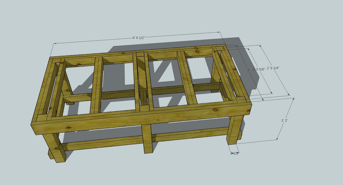

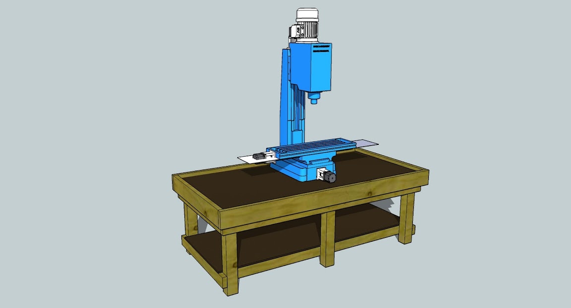

    Post Table Specs - plans, cut sheet, sketchup model
    Any feedback? I would have used all 2x6's but Home Depot had a full rack of pressure treated 2x4's at 85% off. The warp was quite minimal. Everything will be lag screwed together so I will glue/screw the arches into each other for the trusses and balance out the warp. I Dont think It should add too much tension to the structure.
    Thoughts?
    note: The mill in the above picture is an Industrial Hobbies model that had been compressed on x and y to fit into the dimensions of my model. It was a quick/dirty fix so I could plan my stand. It is NOT a correct drawing. Everything is miss sized, ratios and measurements are wrong. It is a good x,y representation of my DM45. The planes you see are the range of motion.
    I finagled with the dimensions, I was able to cut 3 inches off of the depth, and any gained real estate in my shop is worth while. rather than re dimension every piece I used scale to go 95% Y. So if things look a tad oblique that is why.

    I made the table for my first machine......
    Hey man I made the table for my first machine from heavy timber too.... lasted a very long time and worked just fine. I lag bolted everything together and used some dado joints here and there to make it more rigid. That looks like a nice machine. I think you will love it when you get it cnc'd.... Lots of beef on these mills..... I made my table top with two sheets of 3/4 ply laminated together and then I sheeted it with some stainless sheeting applied with contact cement..... That was for a manual machine tho and no thought of flood coolant.... you can make a nice enclosure for the mill from wood as well and fiberglass the seams then paint it with some quality industrial paint. That is what I did and it is holding up well.....
    Looking forward to seeing what you do with your build and how you choose to do things.... lots of options and ideas. Good luck with it and peace...

    Your drawing skills are quite good.
    I made one mill stand out of wood and it works fine and it flexes less than the steel one I made for the IH mill. I made the wooden stand a bit larger than the mill to give me a place to set things.
    After five minuets of milling it had 1" of chips on it which is just another surface to clean up. I kind of like the open steel frame stand better it just let the chips hit the floor so clean up is a bit faster.
    Your mill looks a bit different than some of the other RF-45 clones I have seen. The column looks about the same size as a IH mill but the bolts are standard hex not SHCS. The Z collar looks longer than most of the clones, like the IH, but it does not have the 12" mounting ring.
    Do you get 13" of Y travel?

    Thank you both for the encouragement. And I completely forgot to mention the mill you see in that image is COMPLETELY skewed. Someone drew up an Industrial Hobbies mill and uploaded to google 3dwarehouse. I grabbed the model and compressed it using scale until the dimensions were correct for x,y, and z only. Then drew the planes for the travel so I could visualize how large it would be. I am a completely visual learner/builder, I need a picture in my head of scale before I start cutting wood or I have no confidence that it will be correct when finished.
    I will make a note by the drawings. So if yo are impressed by my 2x4 drawing 1337ness then thank you! :-) otherwise I give credit for the real piece in that image to its author.

    The only thinking I would change would be to notch the 4x4 legs so that the table framing is sitting on the 4x4 and not hanging by leg screws. I

    maybe it is better to make a stand with a steel? i have the same machine now and i have to mount it in a top floor. I decided to disassembly the machine because there is no way to lift it through a staircase...
    I like that idea, but wouldnt that trade vertical support for torsional rigidity? (taking a 3.5 inch contact area down to 2 inches on outer four legs) I figured my lag screws and construction adhesive would do for vertical support. The shear strength of 5/8 steel is pretty decent, I will run the numbers before gluing her together. It rained all day today, lumber outside, no building. Sad sad day...

    The trick to making a wood table total non wobbly is to use shear facing on three sides.
    I faced the three sides of my work bench (The old one I called old shaky.) with 3/4" chip wood and the same with three sides of the mill stand and there is almost no flex at all. The mill stand could have used three layers of 3/4 for the top or better supports directly under where the mill sits. The wood does adsorb vibration better than steel.
    The steel stand rings and does this strange shimmy thing even with a good amount of cross braes. I will have to rebuild the whole thing.
    You didn't say if your mill comes with about 13" of Y travel? It sure looks like it is IH mill sized which is really the next size larger RF-45 mill with all the ways being wider and larger and longer than a RF-45. Do they call it a IH clone?

    Here is what I am talking about.
    The problem with the doubled up 2x6 hanging off the front and back 2x6 is that they are stronger than the 2x6 they are attached to. I would suggest just going with single 2x6 instead of the doubles and making sure that they are spaced so they aligned with the base of the mill. Also I would add a 4x4 to the rear to help carry the load and if at all possible one to the front as well. Also as mentioned I would sheet the rear and sides in with plywood to add strength to the table and to remove and side to side and front to back motion that will come when jogging the table.
    My mill is a lot smaller then yours and this is what it does to a table.

    good info, it is a little late to cut the slots, but I will plywood the surrounds. That would be much simpler than cross braces and more effective (if I use glue and assure connection all the way around.)
    I didnt measure the Z travel, but x and y are RF45 for sure. It really is about 20% smaller than the IH. You would need to ask yourself if the extra 800-1000 dollars would be well spend for the larger table and travel. If you want a good comparison, get into sketchup and download the IH model, then copy it in your workspace and scale one down about 80%, or just resize the table and base. I was surprised at how they looked side by side-however what I have is still huge, and being my first mill I am not crying for more space...yet..
