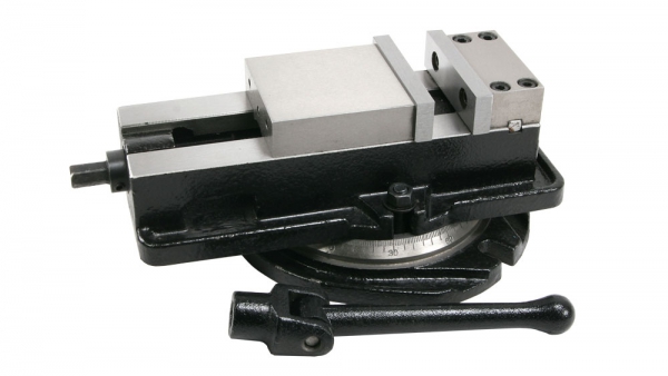

    LMS VISE
    I have stripped out the bolts that allow this vise to swivel - So this is a warning for those of you who have this vise. I just threw some 3/8" bolts in and they work perfectly. Still though, those bolts seem to be made out of aluminum, that's how soft they are...
