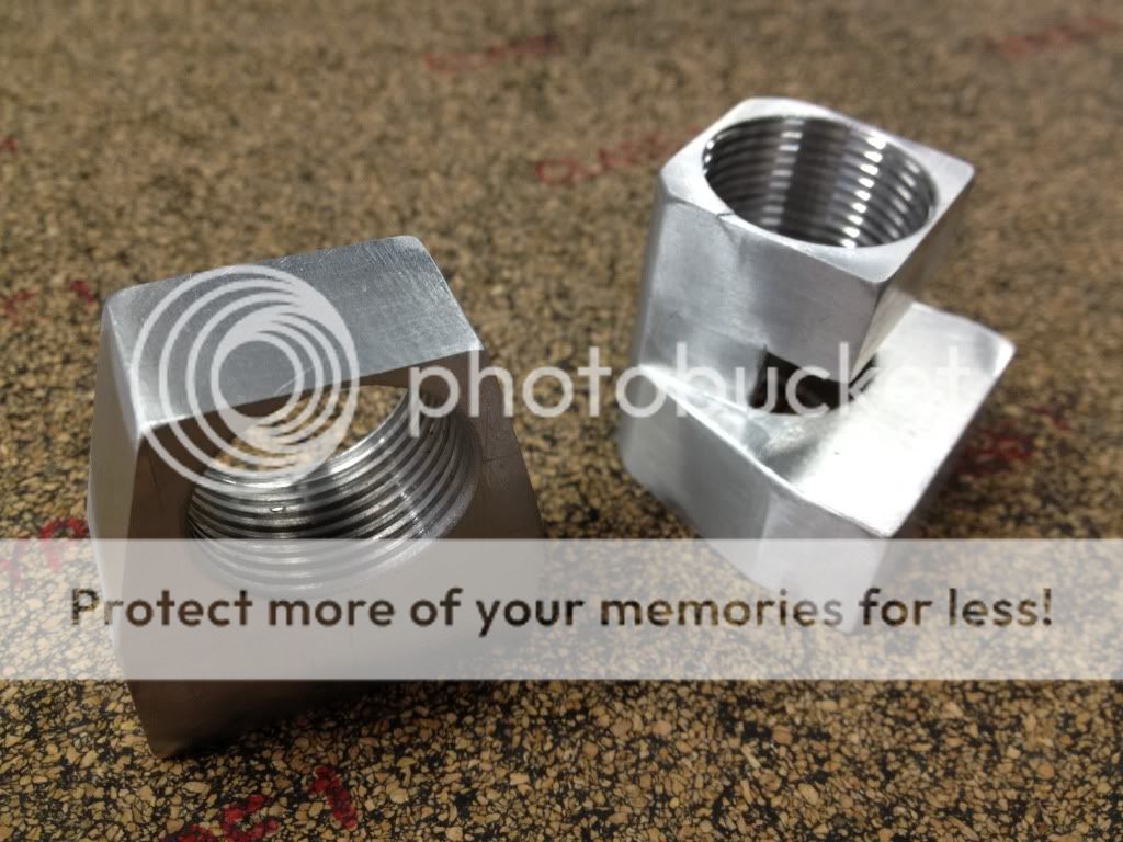

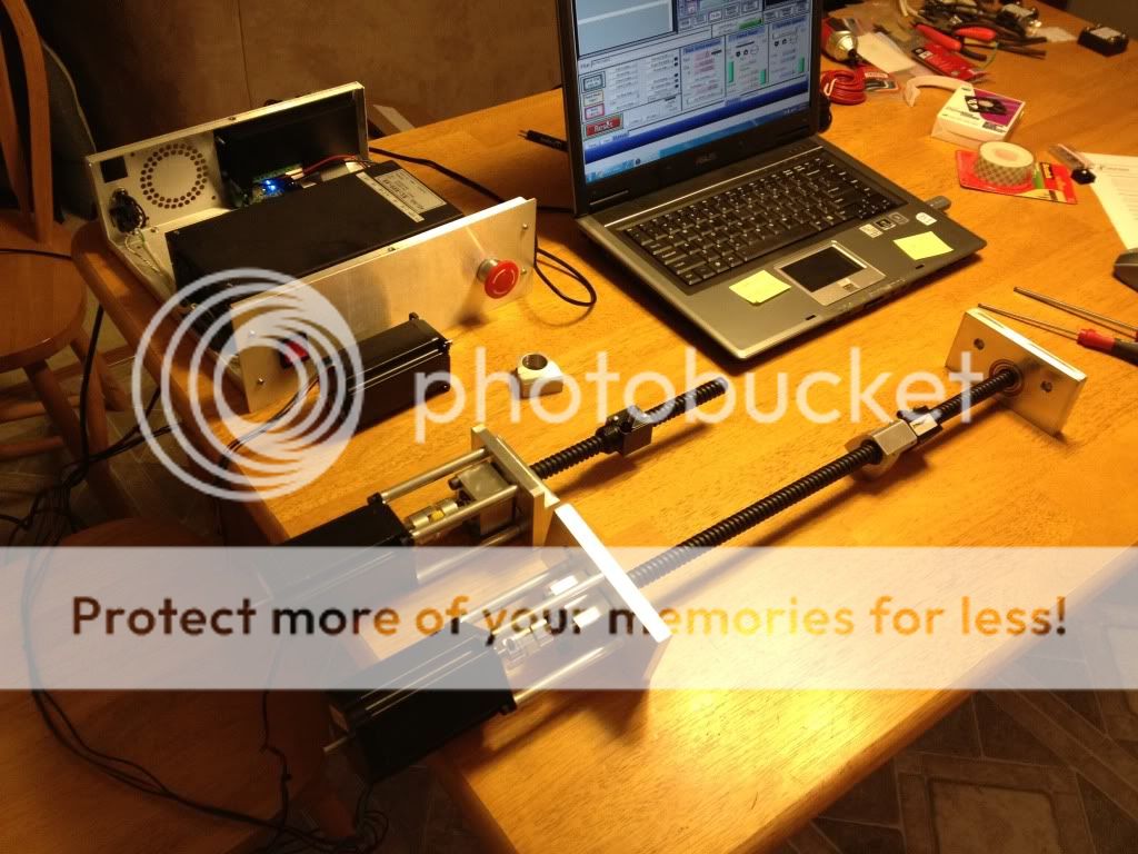

    Hi guys -
    I have been lurking in this forum for quite some time, and finally pulled the trigger on an LMS solid column HiTorque Mini Mill as well as a HiTorque Mini Lathe. I have never done any machining before, but am anxious to learn. After watching numerous youtube videos and reading a couple of machinist books, I started learning to use the tools. My first big project, of course, is to convert the mill to CNC.
    I thought about just purchasing the CNC Fusion kit, but I felt that for the price I could take it as an adventurous learning experience and build something myself. Also there are just a couple of things that I am not fond of with the kit - the extension to the X-axis, covering up the Z gibs, and the preloaded bearing mechanism.

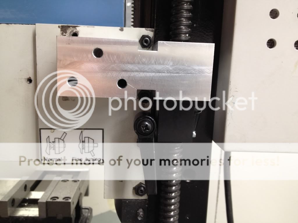

    Rather, I decided to grind away some material on the underside of the table in order to fit the ballnut mount inside the carriage, eliminating the table extension. I also followed the preloaded angular contact bearing methodology found on CNC cookbook: CNC Cookbook: Eliminating Backlash, Part 1
    Well, I started this journey about 3-4 weeks ago, so I will post some pictures now. Unfortunately, I got deep into the work at various points and forgot to take pics.

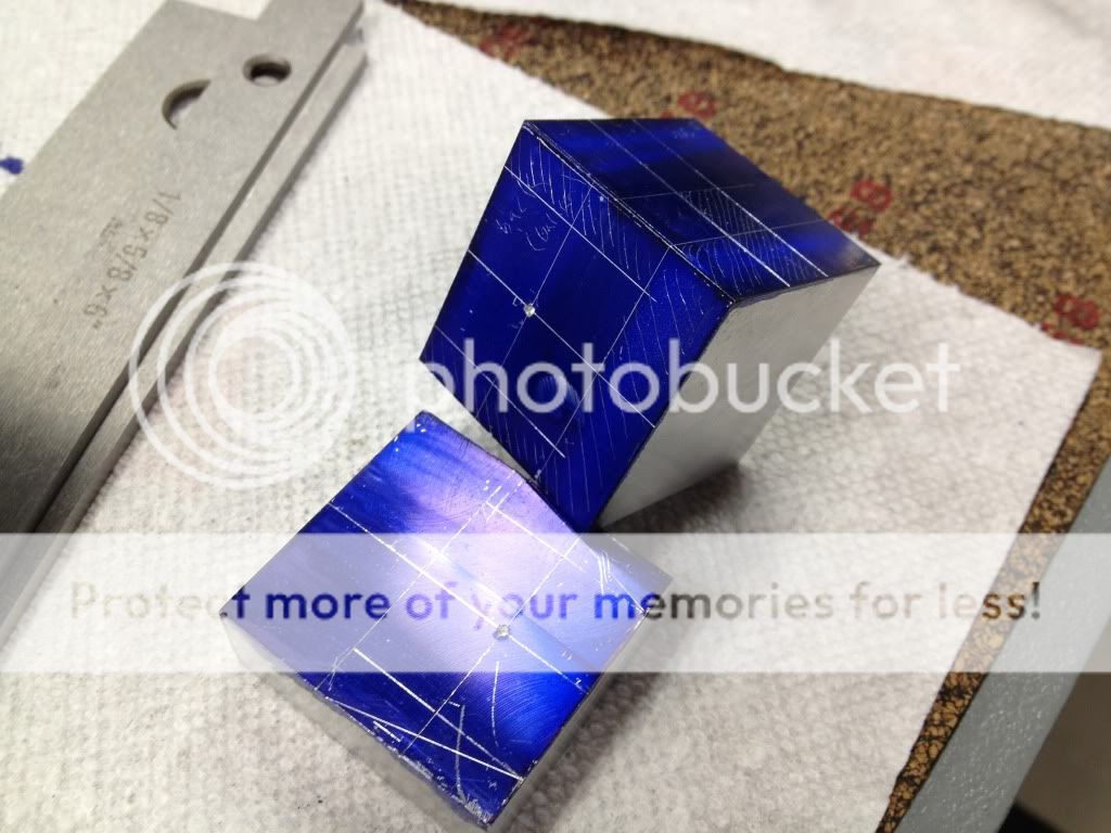

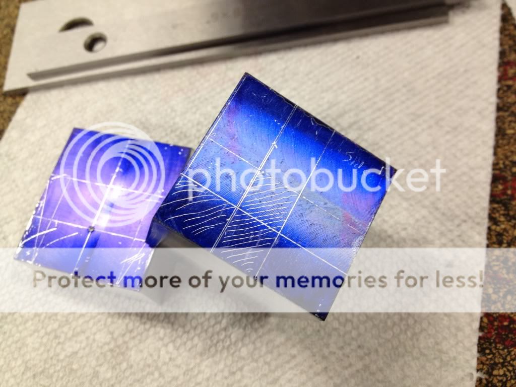

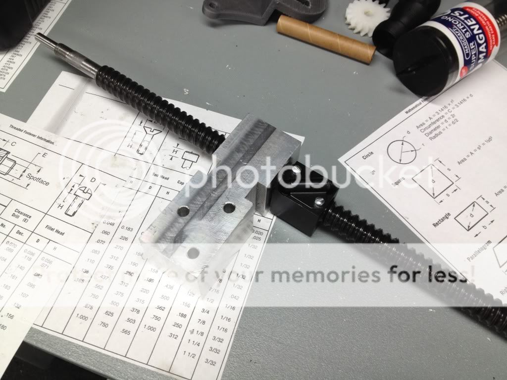

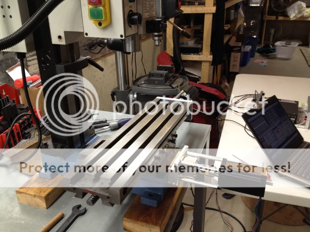

    Laid out my first couple parts - X and Y ballnut holders
    Test fitting and grinding down the table a bit for fitment

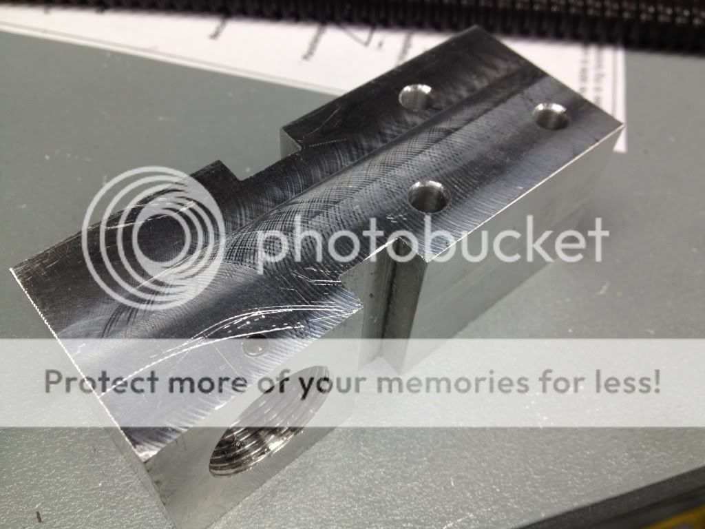

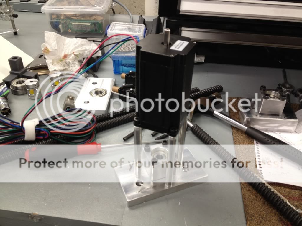

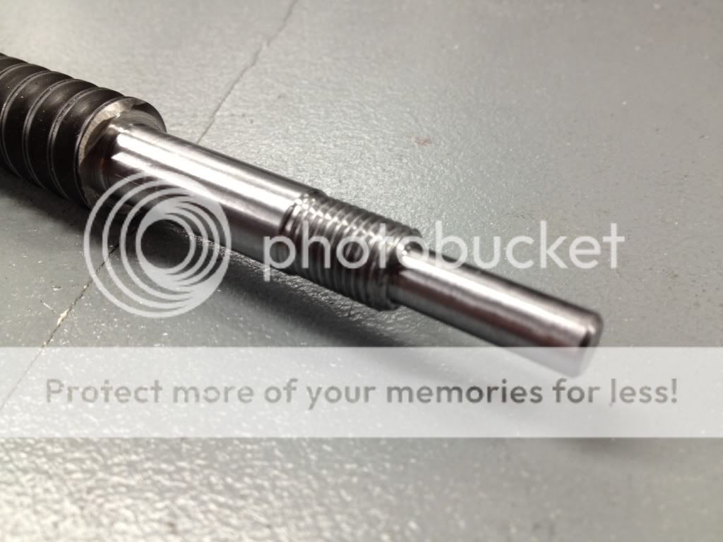

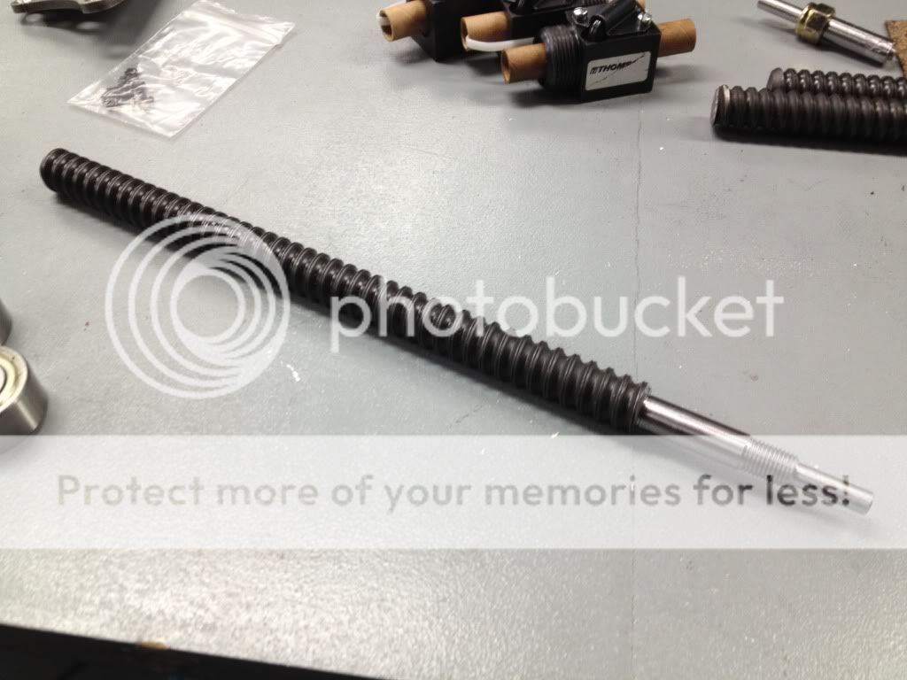

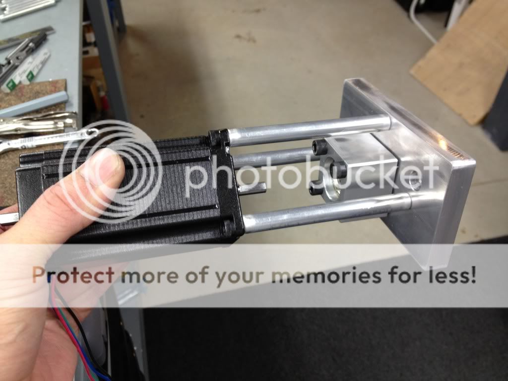

    Making X table ends and bearing holders. Wanted to use dual preloaded angular contact bearings.

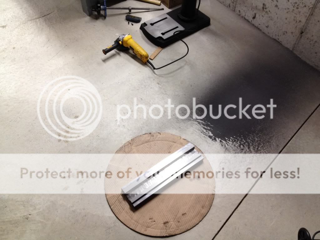

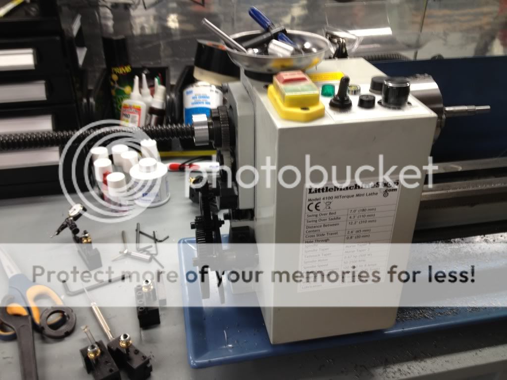

    Since I only have a Mini lathe, My attempts at machining the ends of the ballscrews were rough - it could be done, but at a very slow and index-breaking pace
    So I cut them down with an angle grinder, faced the end, and drilled and tapped a hole. Then made a threaded end out of steel and attached it to the end of the ballscrew with red loctite. 24 hours later, i chucked the whole thing in the lathe and machined the ends. Here is a small trick I used to hold the 2 ft lengths securely in the chuck without wobbling

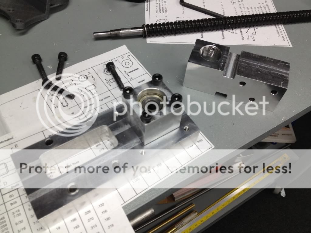

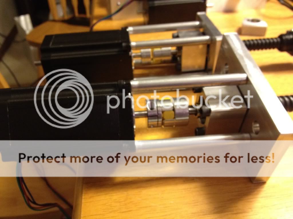

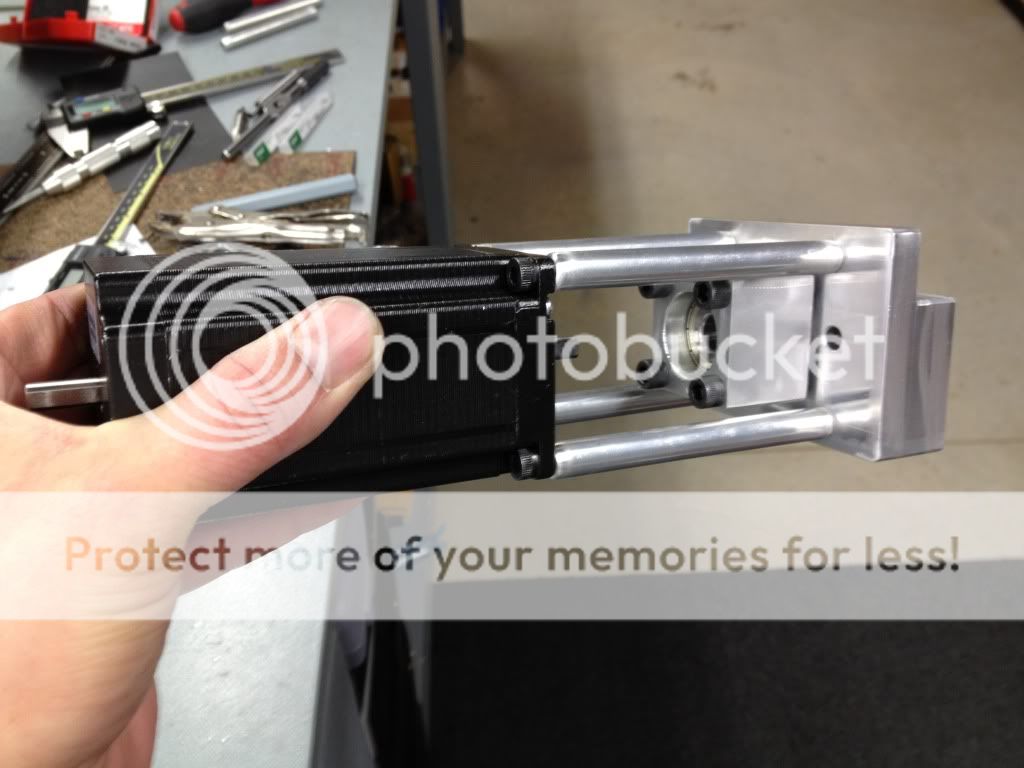

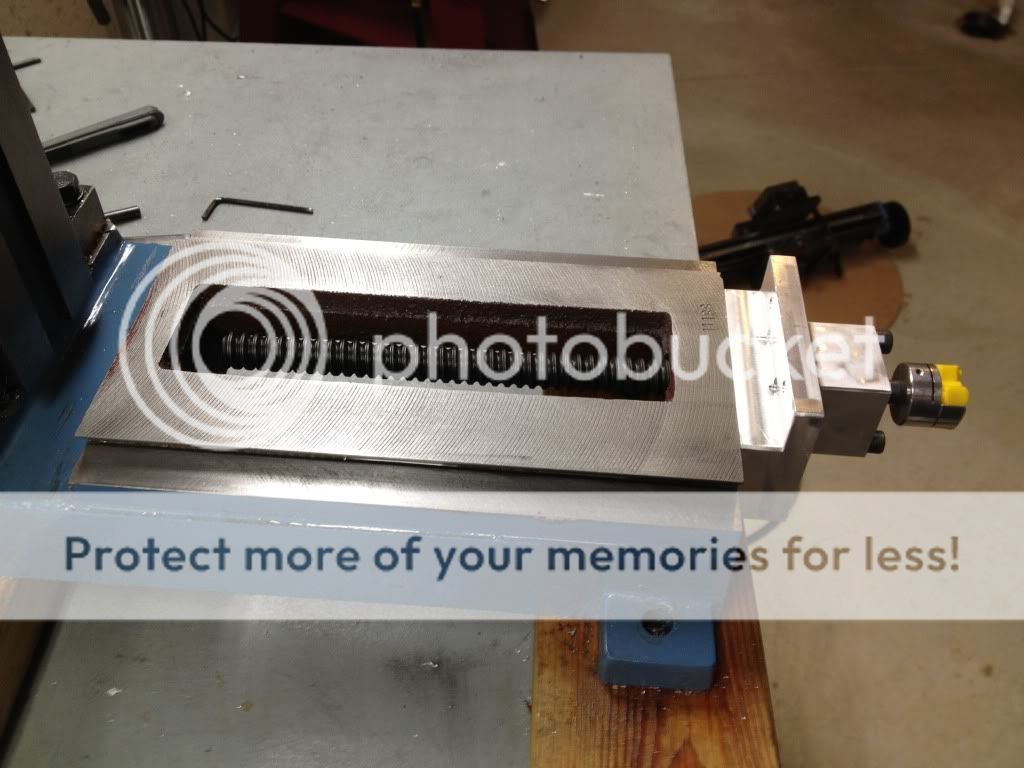

    Here are the X and Y mounts with bearing holders after I got them all machined and assembled

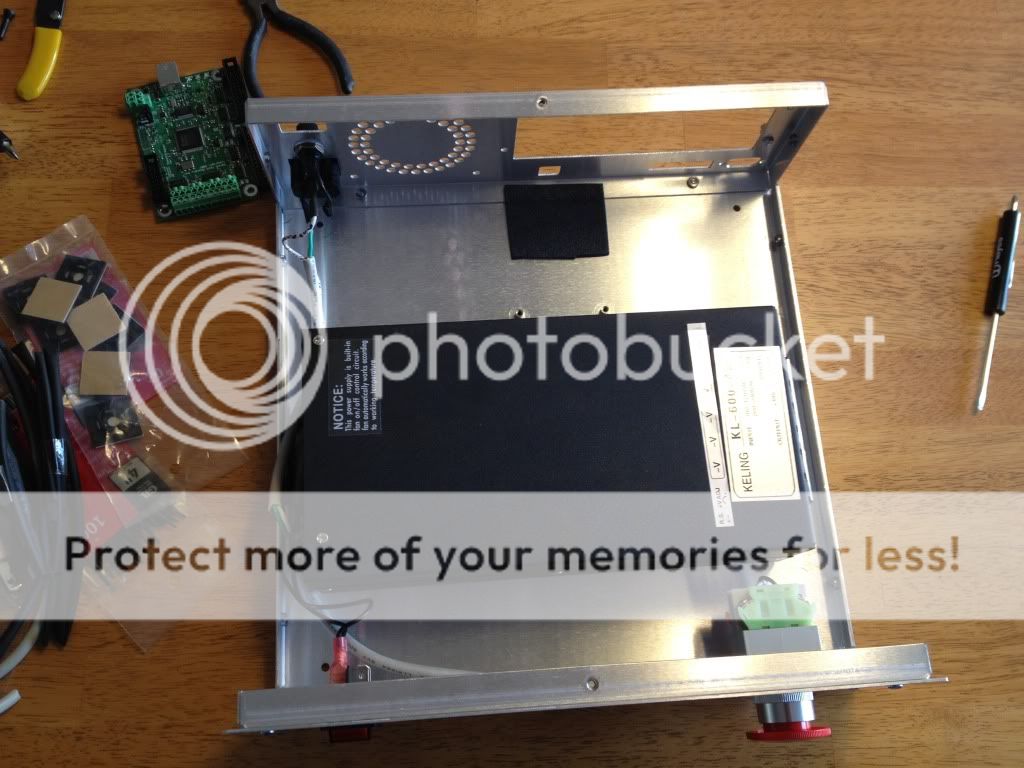

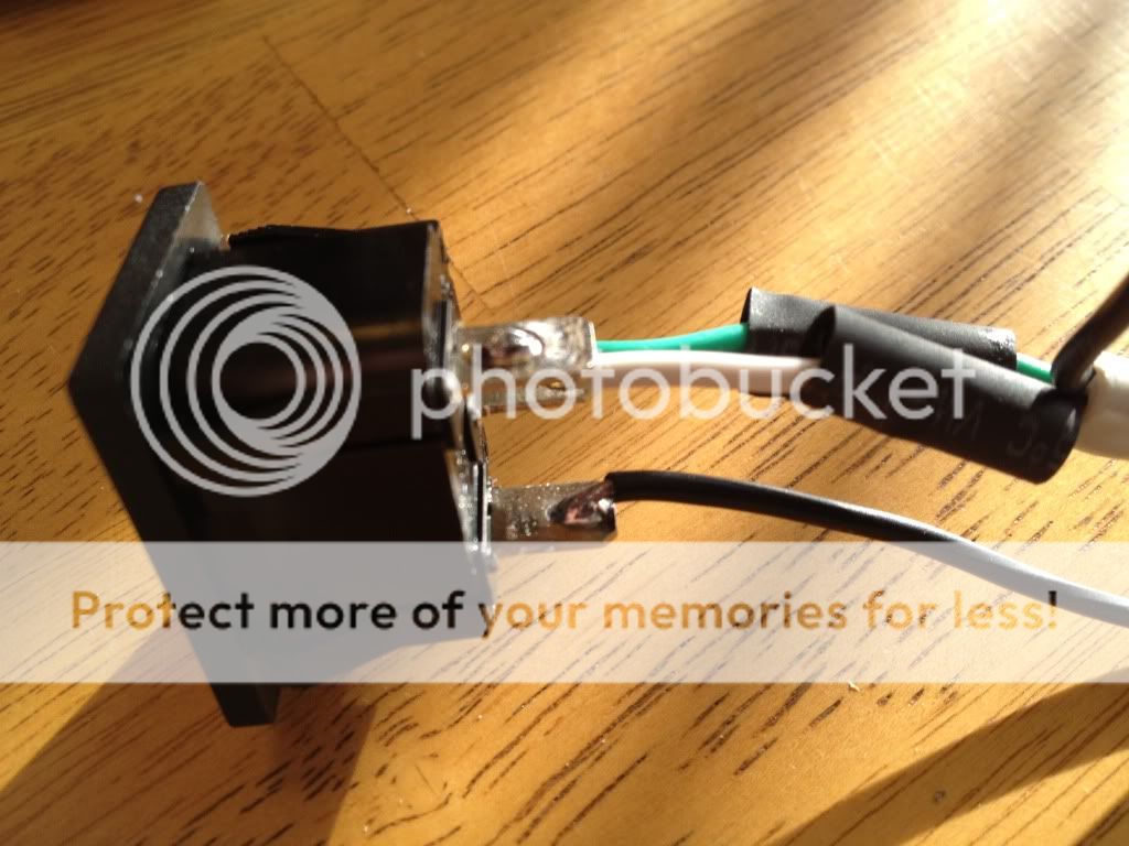

    I then received a big order from Keling (AutomationDirect). It was a lot more work than I thought to put the controller box together. I carefully soldered all connections to ensure solid connections. I didn't take enough pictures but I also ended up putting a solid state relay for spindle control.

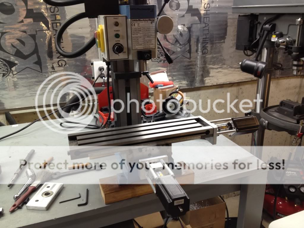

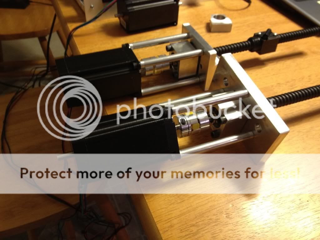

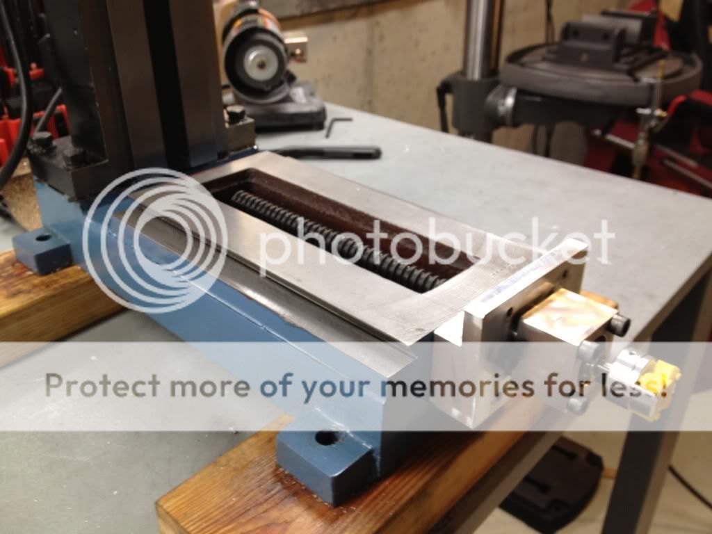

    Finally, the X and Y came together!! I figured this would make the Z-axis parts much easier to fabricate.

    Fantastic work! I have a 10x22 lathe and I also used exactly that method to make the end of my Y axis screw anyway. No squeals, howls, groans and other noises from the lathe and once the lock-tite set that sucker was not going to budge, certainly not with the force a 570 oz-in stepper could produce.

    Nice work. How are you dealing with the ballscrew backlash?
  11. #11
    Join Date
    Nov 2011
    Posts
    0
    Thanks for the comments!
    As for backlash handling, currently I am still working on that. I preloaded the Thomson ballnuts (which come stock with .124" balls) with .125" balls. However, I feel there is room to go even larger, so I ordered some .1255 and .1257" balls to try out. I will do some experimentation until I get the optimal mix of preloading and low-friction. Currently, I am seeing around .006 " of backlash in each axis..
  12. #12
    Join Date
    Dec 2009
    Posts
    1416
    Might check those couplers. I have heard several people complain of the backlash in those.

    Quote Originally Posted by photomankc View Post
    I'm not certain from the photos, but aren't those Oldham couplers?
  14. #14
    Join Date
    Dec 2009
    Posts
    1416
    Looks like Spider couplers to me. Oldham has a single slot/key on each end. Spiders have the prongs with the X shaped peice in the middle.
    I'd say measure the actual screw backlash by grabbing the table and push/pull on it to see how much it's moving. If that amount is anything less than what you are seeing when jogging it then you have to chase down whatever else is causing it. 0.006 sounds like a lot for brand new ball screws.

    I get .003-.004 of system backlash from the Thomson screws. I managed to reduce it to less than .001 by using 2 nuts. I'm also using the same Lovejoy type coupling. Unless the gibs are very tight, I found that they contribute less than .0005.

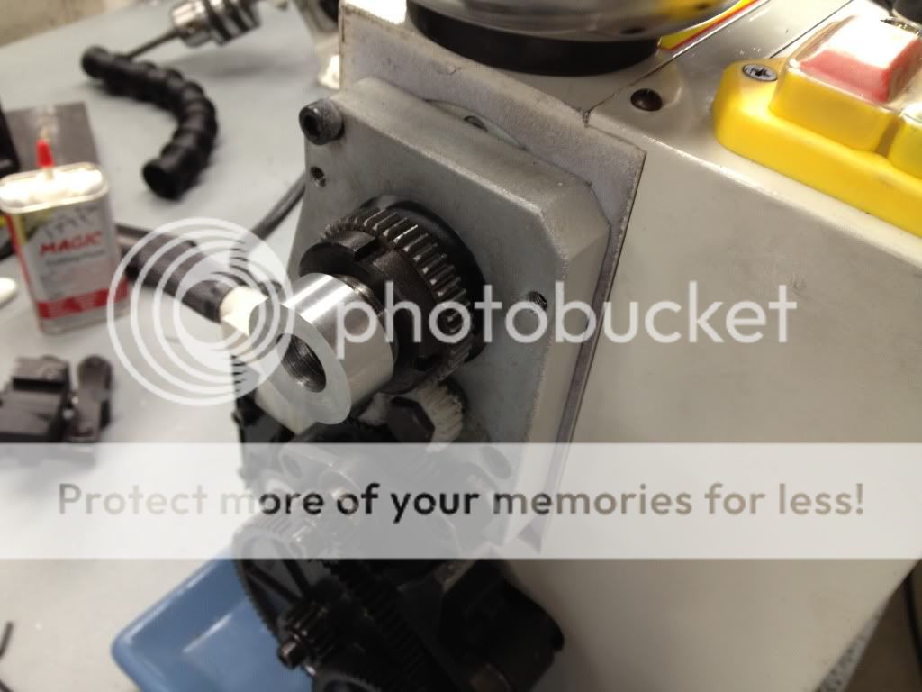

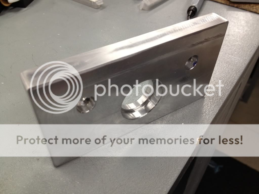

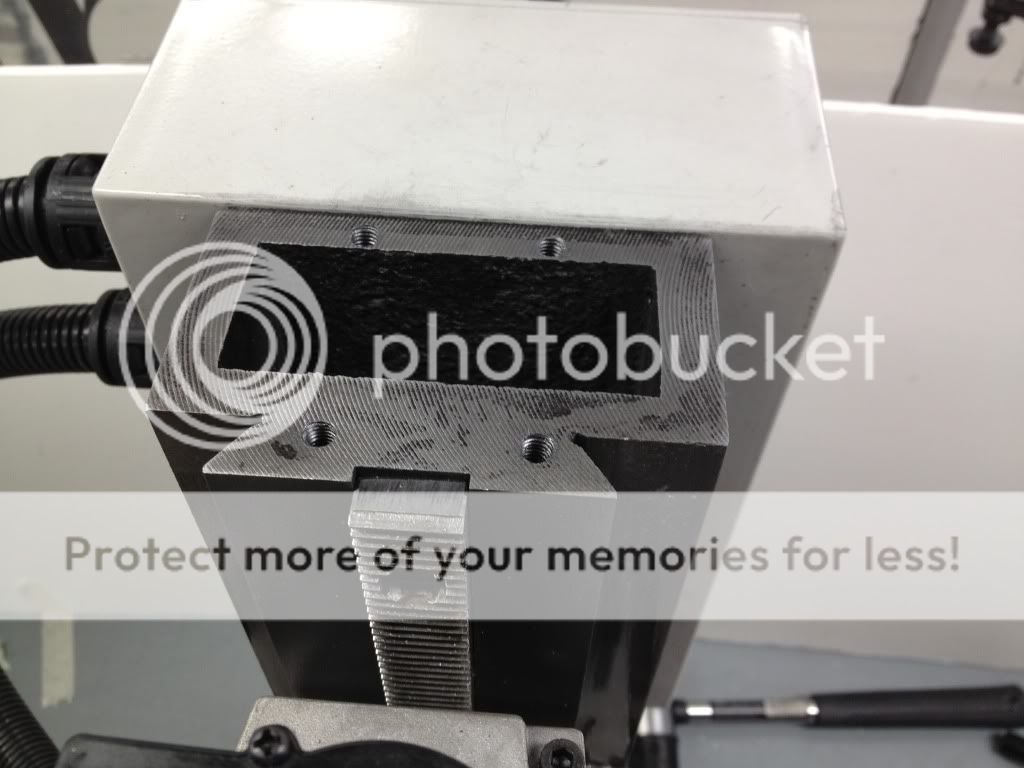

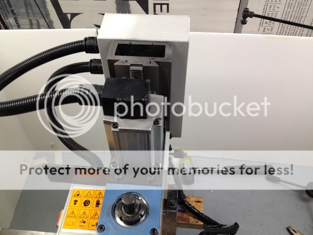

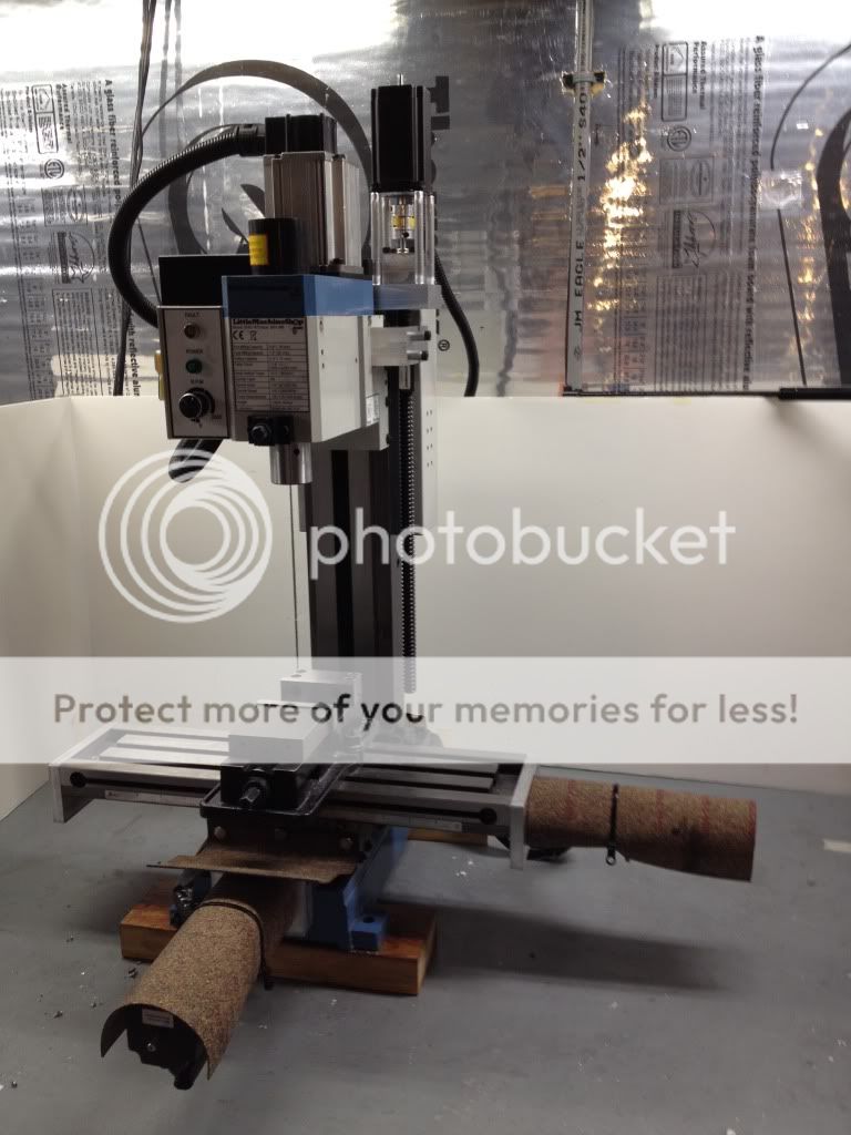

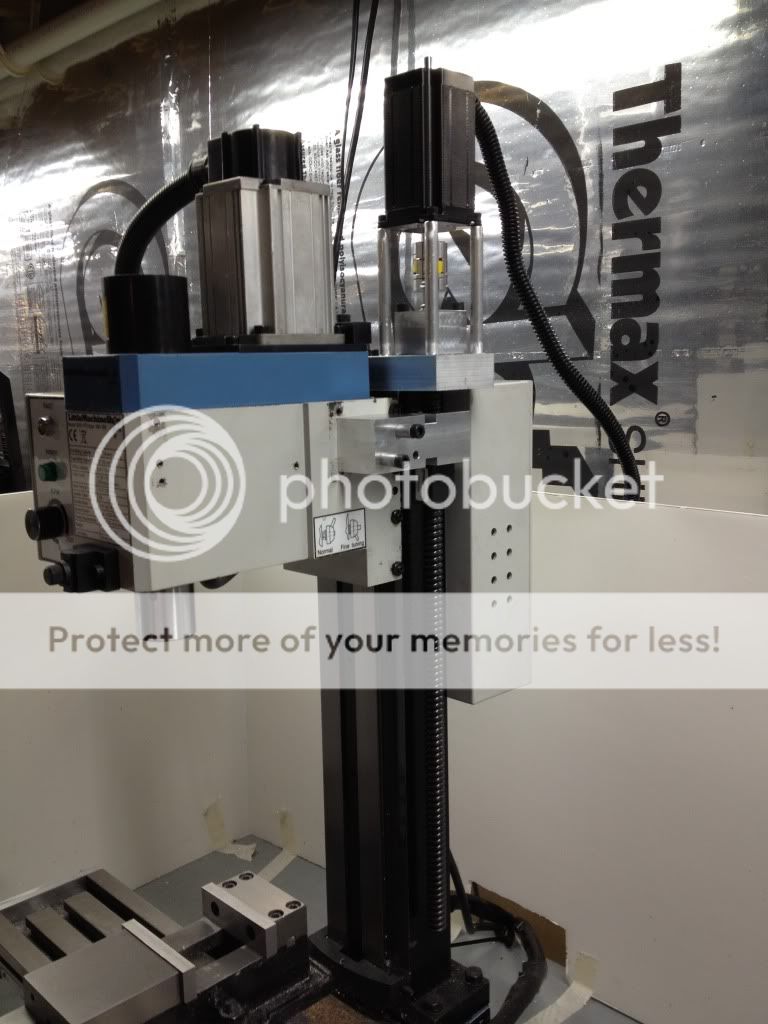

    UPDATE: Z-AXIS COMPLETE!!! :cheers:
    I stayed up most of the night Saturday finishing it up. I goofed up a little bit on the ballscrew mount (made 3 screw holes, 1 of them is right over the existing pinion geear shaft hole, oop - will have to make a new hole). Also, the only screws I had were too long, so in a pinch I made some small aluminum spacers to take up the slack. Will get some proper screws ordered up shortly
    As for the Z-axis ballnut, I ordered some different sized bearing balls from Toolsupply, and it appears that the .1257 balls fit very snugly in the ballnuts - no binding, but virtually all backlash is gone!! YAY. Ordering more for the other 2 ballnuts.
    Oh - and for the z-mount, the rectangular hole was made with plans of installing the air spring kit in after CNC'ing. However, with the 381oz/in motor I feel that this is totally unnecessary!
    Here are the pics:

    Looking good! Thanks for posting all the pics. I'm in the process of rebuilding my X2 with the intention of CNC'ing it, and I think I'll take a few note from your build.
    Your Z-axis setup looks like it would work pretty well for me too, but what do you plan to go to protect the ballscrew from swarf?

    Mercyful heavens outstanding..... and you say you have no machining background, I love it and shrinkwrap over the soldered joints very professional and I'll bet you are enjoying it more too that you are machining your own parts and I see you are using the USB Smooth Stepper, keep the pics flowing and thanks for sharing:cheers:
