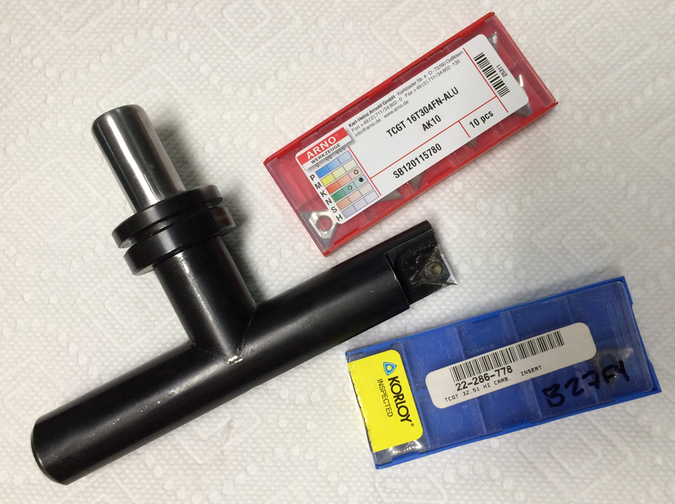

    Cutting a flat surface
    In 6061 and 7075, 8" wide by 5" deep. Using the Superfly cutter in passes 2" apart in Y.
    My machine's tram in X is nearly perfect and also in Y, but parallelism of the table surface in Y to Y movement is off about .0005" per two inches. So I get little ridges at the overlap.
    I've tried shimming the vise a wee bit to bring the work parallel to movement, but that goes against the tram a wee bit so I still end up with a tiny step.
    Any ideas on how to accomplish this? I was thinking of grinding that surface on abrasive against a surface plate. I'm fairly new to trying to accomplish more precision than this, so thoughts from the experienced would be greatly appreciated.

    I am gathering parts to build a TTS compatible fly cutter that can do > 5". A few interesting ones exist out there. I think. But they mustn't be very popular as they are rare. One requires a shell mill holder. The other looks pretty cool, but who knows? You can't find a decent image of it online. I will post back here once I get something working (or not).
    Precision wise, I fussed over the machine base feet thing and again and got the error reduced a bit, but the best solution for this is simply going to be a really big fly cutter.

    Good advice. I am trying two of them, one of which is designed to be balanced. shaped like a "T". The other isn't quite balanced, but I am going to be doing very shallow cuts at as slow a speed as will work. 1000 RPM maybe? Something like that.
  18. #18
    Join Date
    Oct 2010
    Posts
    136
    Tried a few products and ended up deciding this is the one. The B-52 fly cutter. This one is 6" in diameter.
    Very well balanced with no vibration I can see even at 1500 RPM. I am using it at 1000 RPM and 5 IPM with mist coolant on 6061. The resulting finish is very nice.
    Note I pressed a TTS adapter on the shaft.
    I couldn't find much on these cutters on the web, but it turned out to be a good choice. Uses TCGT 32.51 inserts.

    I like a cutter called a Shear Hog from AB Tools. I have a 1 inch single flute one that I can run at 3500 RPM 50 IPM and it gives a beautiful finish and I can plunge straight down. They also offer a 1 1/2 inch and a 2 inch that has 3 flutes. When I had my chop, I had a 2 inch 3 fluter and I used to run that at 7,500 to 10,000 RPM, inch and a half wide 1/4 inch DOC and 100 to 250 IPM, but I had 22 horsepower to work with. The biggest problem with the Shear Hog cutters is the price of the inserts. They are about $18.00 each, and they only have 2 corners. You can get inserts with .010, .030 and .062 corner radii, and I think they are available in .125 corner radius.
    That B52 cutter is a nice cutter, but that tip has to travel a LONG ways around to get back to the part again.
    One thing I forgot to mention, if you use the Shear Hog, keep your broom handy because they throw chips everywhere.
    You can buy GOOD PARTS or you can buy CHEAP PARTS, but you can't buy GOOD CHEAP PARTS.
  20. #20
    Join Date
    Oct 2010
    Posts
    136
    Well, the point of this was to make a flat surface with no steps 5" wide. So while I don't care to swing such a wide and heavy tool, it serves this purpose well so far.
    I will check out the Shear Hog. I do use the Tormach Superfly a lot and love it.
