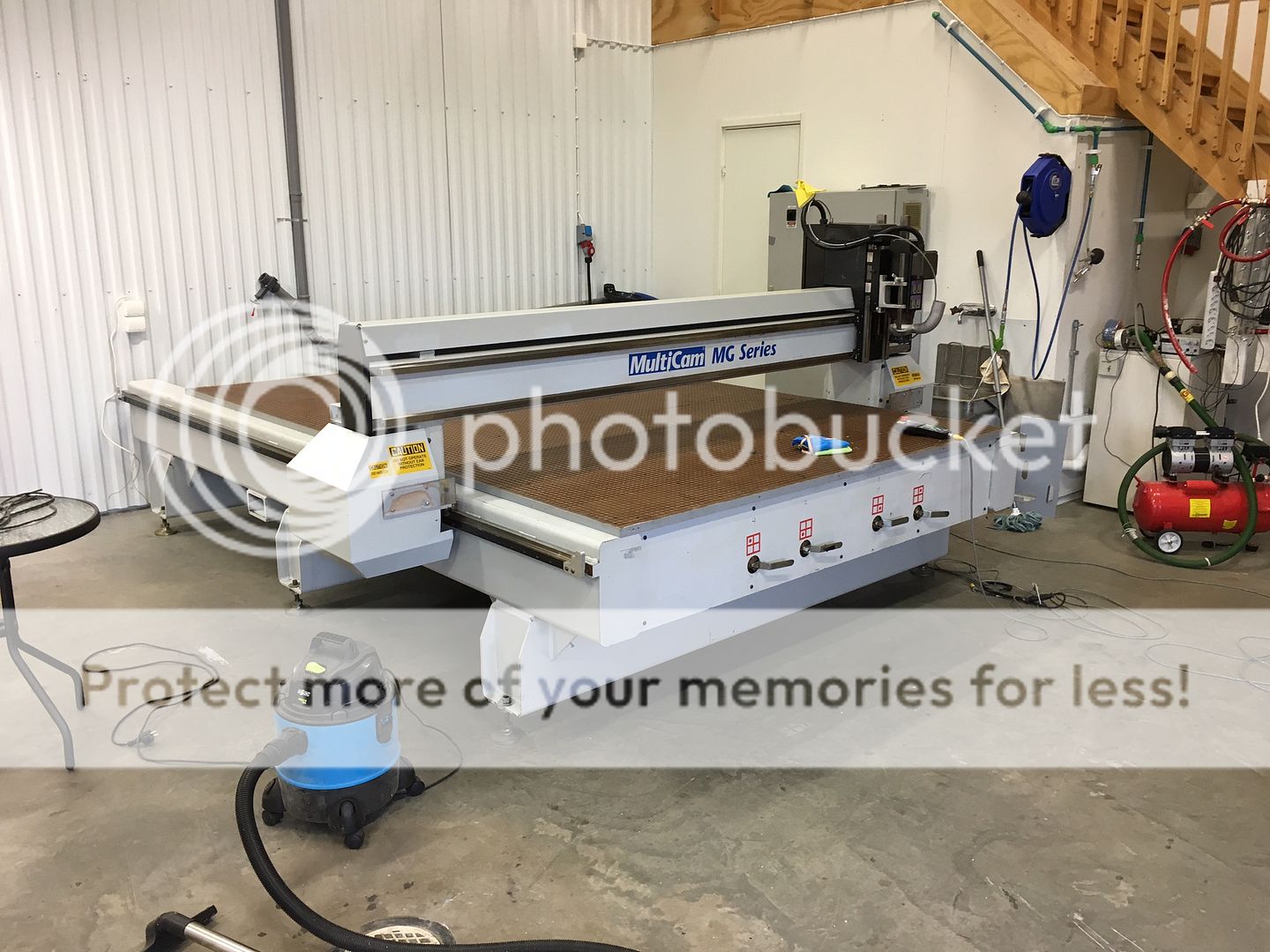

    Re: My carbon fiber CNC gantry
    Quote Originally Posted by Goemon View Post
    What is the gantry made of and what are you cutting when it flexes?
    Those Multicam branded machines look well made in the pics. The gantry beams look thick, it's surprising that flex would be a noticeable issue.
    This is my machine when i got it.
    Side view of the gantry with the cap off. IF i remember correcly steel was about 8mm thick.
    Sometimes i do whole alu sheets of engraved pieces and if I go too fast (gantry makes a sudden change from forward to reverse or vice versa, in the Y direction) the gantry flexes just by its own. Specially if im in the middle of the table.
    The gantry span is somewhere around 2.3meter so its not surprising.

    NIC77, its accually running steppers. And the way the phenomena is most prominently present at the middle of the gantry makes me somewhat certain its flexing back and forth after a hasty change of direction.

    If you mount a dial indicator under the middle of the gantry beam and put some weight on it, you can measure the deflection from the horizontal. That should tell you whether the irregularities in those letters are due to flex in the gantry or something else. If there's not enough deflection to account for your issues, then do the same thing with the spindle. To me, it looks more like something is flexing or oscillating side-to-side than up-and-down. It could be that something's come loose somewhere.

    Awerby, it is flexing side to side. Well front to back if you are standing in front of the machine.

    Glue some ribs inside the gantry tube. They can be as simple as plywood, with a good quality construction adhesive. Make sure they are a snug fit.
    3-5 ribs evenly spaced should make it quite a bit more rigid.

    Quote Originally Posted by ack1 View Post
    Is the gantry beam hollow and if so, what is inside it now?
    It goes to show that you can't always tell how sturdy something is from a pic. A thick-looking steel part could be made of thin walls welded together instead of being solid.
  18. #38
    Join Date
    Apr 2009
    Posts
    5516
    These numbers are very small but you can cleary see what i mean. Look at number 7.
    Have you checked the g-code for the job, especially when it does the number 7? Sometimes CAM puts out crappy code... and sometimes the font, if translated from a Windows or Adobe font, can look "pixelated" even if it's a single line font. Sometimes on what appears to be a diagonal, CAM will spit out something like
    G1X0
    Y0
    X1
    Y1
    X2
    Y2
    and when you run this at speed it looks like it's a mechanical or electronics issue. Not saying that this is the case, but something to look at. Especially with some older machines.

    check all the bolts of Router and Spindle motor..seems looseness..

    I think Louie might be onto something. Looking closely at the results you're getting, the oscillations are suspiciously regular. The number "1", for instance, wiggles exactly the same way each time. If this were looseness or deflection, as I originally suspected, the wiggles would be more random. Check your code, and see if it's in "exact stop" rather than "constant contouring" mode.
