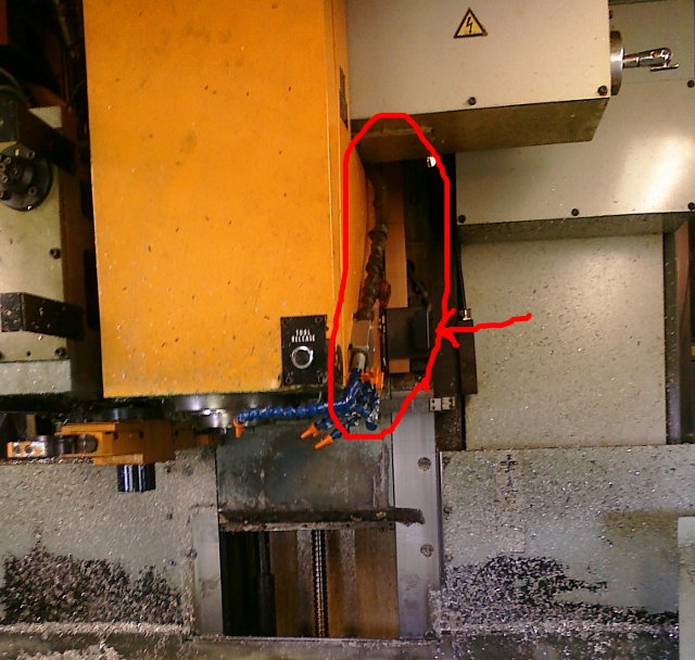

    I started my machine up this morning and ran into a problem that I can't seem to solve. I have a smaller Mitsui Seiki (apx 27" travel in X) vertical CNC machine with a Fanuc 6M controller.
    I began my morning starting it up the same way as always. As I started homing out the axis, I did Z first which went to 0 just fine. Then I switched to Y and when I hit the Jog+ button Z actually went up and overtravelled instead of Y moving. When it overtravelled the Z axis jumped back down just below the limit switch. I got a 434 Z Axis alarm on the screen which I could not clear. So I powered down the machine and keep getting the 434 alarm when the machine tries to power up. Here is a play by play in pictures of what is happening.
    (For some reason the pics aren't showing up in the thread so here is a link to each one too)
    The machine first gets the power turned on and I get my usual NOT READY screen.
    http://www.barchdesigns.com/cnczone/434/1.jpg
    I push my PRP button to power on the servos....
    http://www.barchdesigns.com/cnczone/434/2.jpg
    And the 434 alarm shows up as long as I am holding the PRP button in
    http://www.barchdesigns.com/cnczone/434/3.jpg
    When I let the PRP button go the alarm goes away.....the alarm only shows when the machine is trying to power the servos up
    http://www.barchdesigns.com/cnczone/434/4.jpg
    I checked the servo boards in the back...looks good, green lights
    http://www.barchdesigns.com/cnczone/434/5.jpg
    ...and checked the breaker as the note suggested by some previous owner..
    http://www.barchdesigns.com/cnczone/434/6.jpg
    ....it wasn't tripped and looked ok. I forced it to trip and reset it a couple times just to make sure.
    http://www.barchdesigns.com/cnczone/434/7.jpg
    This is how the machine sits now (I know it is a tight fit to the ceiling). I tried moving the ball screw by hand to try and lower Z to see if that would fix the problem. There must be some kind of brake on it cause it won't budge at all by hand with the machine powered on or off.
    http://www.barchdesigns.com/cnczone/434/8.jpg

    I found the linear scale for the Z axis. It was behind a shroud/cover. I blew air between the read head and the scale. It looked pretty clean, and it didn't affect the alarm after powering back up. Now I am looking for a bad or loose cable somewhere. I am not sure how to test the electronics for the amp/preamp between the read head and the inductosyn board in the CNC.
    The scale has 2 wires and a ground and the read head has 4 wires. Is there a way I can meter these to see if they are working?
    I have a friend coming over tonight to see what he can help with and I am waiting on a call back from a nearby CNC repair company to schedule a tech repair visit (I can feel my wallet getting lighter already...)
    http://www.barchdesigns.com/cnczone/434/13.jpg
    http://www.barchdesigns.com/cnczone/434/14.jpg
