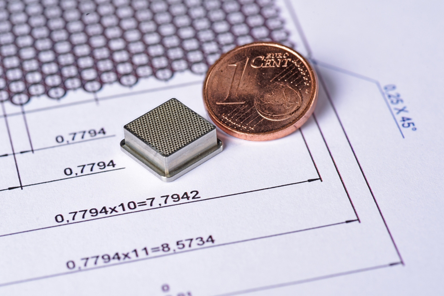

When it comes to the fibre-optic components from Amphenol Precision Optics GmbH, the utmost precision is essential: The connectors must be extremely precise, because the ends of the two fibre optic cables (FOC), each nine micrometres thick, must align perfectly with one another in order to achieve full transmission performance. That is why the company with headquarters in Sinn-Fleisbach, Hesse, relies on laser measuring systems and probes from Blum-Novotest for its production processes.
Whether in laser technology for medicine, defence or data transmission in the fields of infrastructure and sensor technology, the fibre-optic components from Amphenol Precision Optics GmbH are the central link. After all, the company, founded in 1972, began producing fibre-optic components as early as 1987, although at that time it went by Euromicron Werkzeuge GmbH. This step marked the entry into the world of optical connection technology, which remains its core business to this day. Standard connectors from the EST and SC families were mostly produced at first, which made it the market leader for fibre-optic connectors in Germany at the time. With the growing demand for high-precision parts for fibre optic cable connections, Euromicron Werkzeuge GmbH has evolved into a highly specialised manufacturer in the fibre-optic industry. Today, Amphenol Precision Optics GmbH is one of Europe’s leading providers of fibre-optic connection technology.
