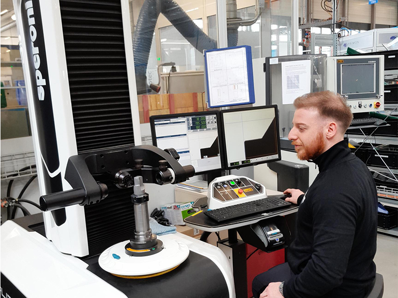

Fast and reproducible measurement is an important factor for stable production operations. For this reason, the company has been using a Speroni STP 46 Futura CNC model since 2014, which, according to the company, continues to provide consistent accuracy and repeatability after more than 12 years of use.
According to Andreas Röthlisberger, Head of Resource Management, the system measures between 50 and 80 complete tool assemblies per day. The measurement of a complete tool takes approximately one minute.
Speroni’s expansion from Italy into Switzerland was supported by a long-standing partnership with the CNC tool manufacturer BIG KAISER (today BIG DAISHOWA), from which the project with Nussbaum developed. The collaboration between Nussbaum and Speroni has been in place for more than 12 years.
The STP Futura 46 Full CNC is equipped with the Speroni Lasso Function, enabling precise scanning of complete tool profiles, as well as a range of HSK adapters that support the repeatability and changeover accuracy. These features optimize tool management and setup, as well as minimize downtime.
