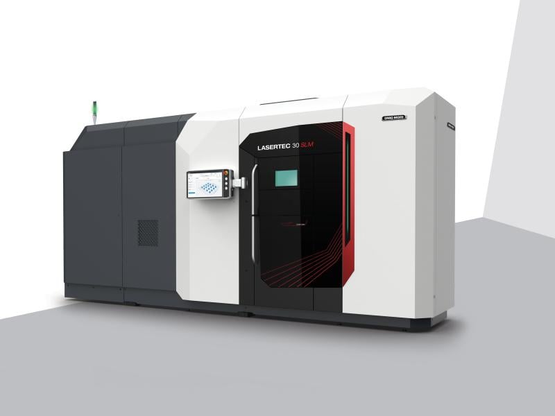

LASERTEC SLM: Ultra-hard milling heads from the powder bed
Both the LASERTEC 12 SLM exhibited at GrindingHub and the larger LASERTEC 30 SLM
3. Generation serve as productive solutions for the additive manufacturing of milling heads in a powder bed. The decisive advantage over conventional manufacturing processes lies in the complex geometries that the additive process can achieve. For example, internal cooling channels can be integrated, ensuring optimal heat dissipation when machining with ultra-hard cutting materials. On the control side, LASERTEC SLM machines feature CELOS X with easyAM. This makes the powder bed machines easy to operate and maintain. rePLUG powder modules also enable quick changes between different materials.
