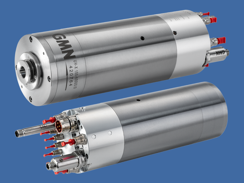

The new, resource-saving UH grinding spindles from GMN enable greater productivity and production quality. They achieve their high efficiency thanks to the synchronous drive used for the first time. Thanks to the IDEA-4S embedded system, they are also the first IIoT-capable models as standard. This makes them part of an overall concept for the digitalization of spindle technology for milling and grinding machines.
