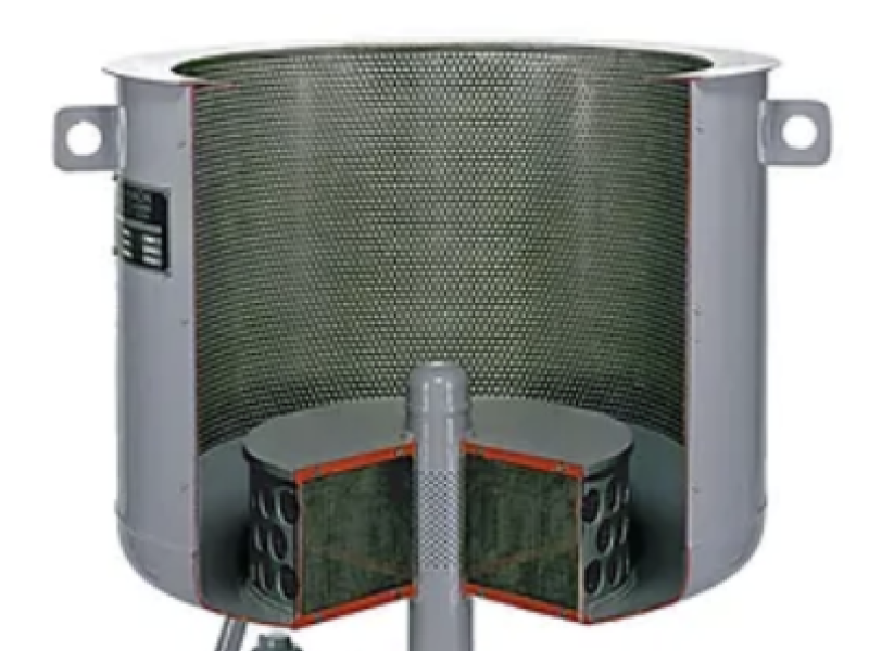

Glaunach GmbH, based in Austria, supplies its products to 95 countries, boasts a global track record with over 10,000 projects, and is regarded as a leading supplier of silencers.

GLAUNACH Vent Silencers
