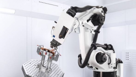

Faster welding times thanks to rotary module for shield gas guidance
Shield gas is used in laser welding to ensure as oxide-free a weld as possible. Before, the shield gas has been applied via a four-finger nozzle fixed to the processing optics. This meant that the whole laser head had to turn whenever there was a change in orientation. Thanks to the rotary module, the new TruLaser Weld 5000 features a movable nozzle that rotates around the optics. The result is faster welding times, since the robot does not have to reorient itself as much. This also simplifies programming and fixture design.

The design of the TruLaser Weld 5000 departs from its predecessor in various aspects. This version of TRUMPF’s laser welding cell features the striking cube design. It also comes with a swiveling support arm for the control panel, which contributes to ergonomic working and improved handling. On the exterior, TRUMPF has now fitted the TruLaser Weld 5000 with a status light, as successfully employed in the TruLaser Cell. These lights provide an immediate assessment of the machine’s status. A continuous blue light, for instance, indicates that the machine is in teaching mode. Bigger windows provide a better view into the safety cabin, and on the interior there are new approaches to lighting and suction.
The laser welding unit operates using a TRUMPF TruDisk laser that can also power other machines such as a 2D laser machine. In this sort of laser network, several machines share a single laser – which can significantly reduce the initial investment costs in a new machine.
