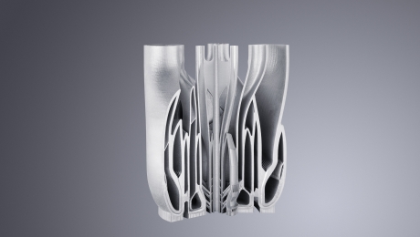

TRUMPF, the laser systems manufacturer and Industry 4.0 pioneer, is at the Formnext trade fair in Frankfurt to present its new 3D printers - TruPrint 3000 and TruPrint 5000. These medium format machines are based on laser metal fusion (LMF) technology, using lasers to generate complete parts layer by layer in a powder bed. These parts can measure up to 300 millimeters in diameter and 400 millimeters in height. With an ingenious tool change cylinder concept, which allows the construction chamber and supply cylinders to be switched out quickly, and an industry-ready periphery, these new machines are geared towards the large-scale production of complex metal parts. What's more, with the TruPrint 3000, TRUMPF is putting the spotlight on the complete process chain for additive manufacturing.
