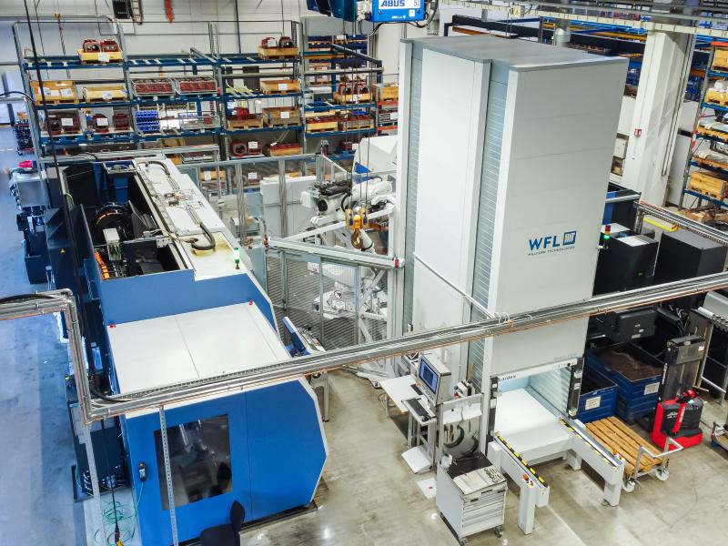

A highlight in the modern production hall is the fully automated machining cell featuring two M65 MILLTURNs, a Kardex lift and an ABB industrial robot with a bin-picking system. The machines are primarily used to manufacture rotors for rotary lobe blowers. These products are mainly installed in the Delta Blower series. These versatile and compact units can be used in any climate zone on Earth. Production covers small to medium profile sizes. The workpieces are mainly made from C45 and EN-GJS-500-7 materials. In theory, the entire Aerzen product range at this site – namely screw blowers and screw compressors – can be produced on the MILLTURNs. Delta Hybrid rotors are also planned for the plant in the future.

One challenge in Research & Development for the automation system was the interface between the ERP (Enterprise Resource Planning) system and the host computer, which was needed to automatically identify orders. The operator approves the order in SAP, and it is automatically assigned to the machine. The forklift operator then delivers the pallets of blank parts and the corresponding pallets of finished parts; the machine operator selects the order, and the robot first retrieves its blank part from the relevant pallet via bin picking. It then retrieves its program from the tool management system – another interface in the machining process, in this case to Tool Doc. Here, the host computer checks whether there is sufficient material in the Kardex lift, i.e. whether all tools are present and have sufficient service life. Once the status check is successful, the program is started. The robot then retrieves the blank via bin picking and places it on the pre-storage area. It measures the position of the finished part pallet, which has been preset by the operator. The doors of the M65 MILLTURN’s working area open, the blank is clamped into the machine, and the program then starts automatically. The same process is carried out on the second M65 MILLTURN. This creates a fully digitised process – from order creation through application to storage in the Kardexlift with twelve storage slots.

With automation, Aerzen has achieved a significant increase in efficiency. Whilst the actual machining times have increased slightly due to automatic position detection, waiting times caused by manual operation have been almost completely eliminated. The robot, firmly anchored to the floor, is ready as soon as the machine door opens – the workpiece is changed immediately, and the process continues without interruption. Visually, the blank has three different flanges. Therefore, the alignment must be precise so that the robot can recognise it and lift it with the yoke gripper. It takes between 24 and 40 minutes to go from the blank to the finished part in the MILLTURN.
“Bin picking emerged from the feasibility study. Without this feature, we would not have been able to realise this project to our specifications,” emphasises Tobias Krebs. He continues: “The bin-picking system has the advantage that we can leave our blanks on the Euro pallets as they are delivered, without having to pre-sort them separately. Accurately identifying the position of the blank parts on the pallet is of immense importance and presented us with a challenge. As parts are often very close together, the bin-picking software required significant optimisation.” “Ultimately, the decision was made in favour of the Kardexlift, as it requires significantly less space compared to other solutions . We also save on unnecessary forklift journeys,” says Krebs.
The plant was purchased to expand capacity, although this is not yet necessary. In future, the plant is set to operate 24/7. Due to the fact that Aerzen has one or more Duplo tools for each tool to minimise downtime, the 90-position tool magazine is almost reaching its limits.
