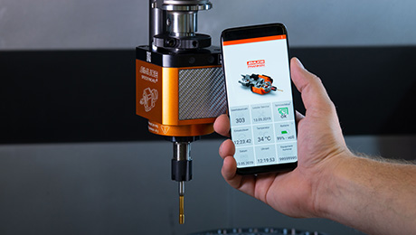

Until now, users of the very maintenance-friendly Speedsynchro® collet holder mostly estimated how many threads were created with it and when a service would make sense. The NFC module now supports the user with precise information such as number of threads, operating time and service status. The app, which is available free of charge from Google Play or the Apple Store, will be installed on a smartphone with an NFC module. If then the smartphone is held to the NFC surface of the Speedsynchro®, the screen opens with all important parameters. Users can then easily check how high the load on the Speedsynchro® holder is and when a service is scheduled.
The collet holder Speedsynchro® Modular/ NFC is provided with an integrated transmission gearing which produces a 4.412 times increase of the RPM of the machine spindle at the tool. The consequently resulting higher cutting speeds reduce the cycle time by up to 50 %. At the same time the machine spindle can be operated in a lower speed range and so save up to 90 % energy.  In addition, the Speedsynchro® Modular/ NFC is equipped with the EMUGE minimum length compensation Softsynchro® reducing the axial forces onto the workpiece. This results in a higher tool life and an improved thread quality. The Speedsynchro® Modular/ NFC is available in two versions: for use with coolant lubricant or for use with minimum quantity lubrication (MQL). The quick adaptation of the tool shanks to male and/or female center or the change between 1- and 2-channel MQL-system is guaranteed by simple exchange of the transfer elements and length adjustment screws. For large series manufacturers the Speedsynchro® Modular/ NFC delivers a quick contribution to more efficiency. Depending on the application an amortization is possible from about 250.000 threads.
