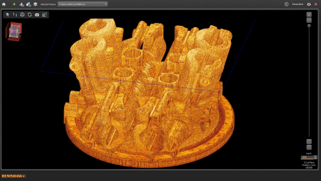

The new software offers two measurement functions in the sensor modules. The first module, LaserVIEW, uses a photosensitive diode to measure the intensity of the laser energy. The second module, MeltVIEW, captures emissions from the melt pool in the near-infrared and infrared spectral ranges. These two sensor signals can be compared to help identify discrepancies.
MeltVIEW and LaserVIEW stream data across a conventional computer network on a layer-by-layer basis, so manufacturers can analyse process monitoring data in real-time. As the build progresses, the data is rendered live in 3D for viewing in InfiniAM Spectral. The engineer can compare the data from each sensor to identify any deviations, which may indicate the presence of anomalies that could lead to defects.
“For additive manufacturing to become a truly ubiquitous manufacturing technology, users and practitioners require a deep understanding of the process,” explained Robin Weston, Marketing Manager at Renishaw's Additive Manufacturing Products Division. “The software will be hugely beneficial to manufacturers looking to achieve consistent processing with AM.”
“The amount of process data generated during an AM build is immense, which means it can be difficult to make practical use of it without the correct interpretation tools,” continued Weston. “InfiniAM Spectral enables manufacturers to easily interpret data and gain a more detailed understanding of their AM processes. Access to real-time data opens the door to future developments in process control – detecting and correcting problems in real-time.”
InfiniAM Spectral will be a huge asset to those producing a series of identical parts in high-value applications. When producing the first part in a series, data from LaserVIEW and MeltVIEW can be compared with existing X-Ray or Computed Tomography (CT) data from a known good part. The manufacturer can use this gold standard signal data and can compare it against data from subsequent parts to judge quality and consistency.
