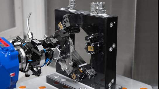

This results in four fixtures which, mounted on machine pallets, are inserted into the machine in just a few minutes and are positioned immediately thanks to zero-point clamping technology. The challenge here is fixing the blanks made of sand-cast aluminium. In a previous concept, two components were clamped and machined per fixture. However, this meant that more interfering contours restricted the machining process. "That's why we now only clamp one blank instead of two," explains Tobias King. "This has reduced complexity and significantly increased process reliability." Now the Grob 350, with its unique machine concept of the horizontal spindle position and swivelling table, can position the workpiece to the exact tolerance for each necessary machining operation after measuring the position.
Clever clamping solution considers all conditions
The blanks are clamped hydraulically with a maximum pressure of 190 bar. This is not entirely trivial with the larger pump housing. "To ensure that we can reach all positions during the machining processes, we have provided three tabs in the design that can be clamped and removed later," reports Oliver Hindinger. Once the EGS articulated arm robot has removed a part from one of the ten pallet drawers, it positions it precisely in the fixture. Then three vertical clamps with a 90° opening angle hold the housing in place with 7.8 kN, making it rock-solid and process-reliable. Additional mounting points are attached to the contact surfaces to prevent the workpiece from slipping. Holes and countersinks can now be drilled, sealing faces milled flat and the inside of the vane pump machined to size. The dimensional, positional and shape tolerances of 0.02 and 0.04 mm are very demanding. Once all the machining steps have been completed, a centring clamp built into the device fixes the pump housing in place. Now the toggle levers release the three clamping lugs so that the machine can remove them.
Although the production of the two covers is not quite as demanding, a few considerations are required to ensure that the blanks are securely clamped. Matching the horizontal spindle position of the Grob machine, the parts are inserted vertically into an arch-shaped fixture that completely encloses them on the narrow sides. Here the hydraulic vertical clamps also hold the parts firmly and securely in place after positioning. After machining, the parts are placed in further drawers of the pallet trolley before they are removed and deburred as well as finished.
