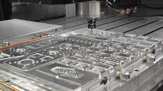

Since spring 2023, two Premium Line vacuum clamping plates from the clamping experts based in Fellbach, measuring 600 × 800 mm, have been attached to a base plate on the machine table of the Hurco DCX 22i. Neubauer has dispensed with the optional AMF zero-point clamping technology for quick changing and alignment of the plates. This is because - and this is the great trick with this solution - individual blanks are no longer clamped at all. Instead of that, large aluminium plates are fixed in place, from which the individual parts are milled out. This means that individual parts are no longer machined in a single clamping operation, but rather many parts are produced at once from the large plate. This already gives an idea of where the 95% saving in set-up time comes from. The designers calculate the optimum utilisation of the aluminium plate with the aim of keeping waste to a minimum.
The individual parts are produced in a five-sided machining process almost to their final dimensions. 0.45 mm of the aluminium plate remains. This is necessary to prevent the vacuum from breaking. The parts are later broken out of the plate, deburred and - if necessary - finished. Individual areas on the vacuum clamping plate can be marked out with the corresponding sealing cord if the entire area is not required. The sealing cords also compensate for minor unevenness on the workpiece surface. The pipework for controlling certain areas and sectors was manufactured by the resourceful inventors at Neubauer themselves. The pumping performance can be precisely controlled using the shut-off valves. The 40 mm high vacuum clamping plate has grooves and 16 suction points on the upper side. This makes it easy to insert the sealing cord. All grooves are labelled with the coordinates so that clamping can be easily reproduced. Holes for stop pins or lateral, height-adjustable eccentric stops make it easy to position workpieces.
Sensitive filters and pressure monitors protect the vacuum circuit
The pipework has a major benefit over plastic hoses that can also be used, as Schramm emphasises: "If the hot chips fly around during milling, they can also burn holes into a hose. Then the system would leak. And we definitely don't want that to happen." This is why the vacuum filter system with liquid separator and a pressure monitor with sensor is extremely sensitive. If, for example, the plate is accidentally drilled through and the vacuum circuit leaks, the machine moves to stop immediately. A clever solution developed by the user bridges a possible leakage for a certain amount of time before cooling lubricant in the circuit reaches the pump and destroys it.
The vacuum required for clamping the aluminium plate is generated by the AMF rotary vane vacuum pump. It ensures reliable continuous operation of the clamping plates used. Because the pump is very compact, it can be installed directly on the machine. A motor power of 0.75 kW suction performance of and 20 m3/h generate a output pressure of 1.5 mbar. Two Venturi nozzles are also integrated into the Premium Line plate, which suck in a maximum of 48.8 l/min of suction volume against the atmosphere at an operating pressure of 3.5 bar and generate a 92 per cent vacuum.
