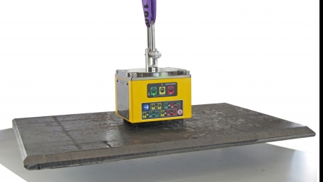

ASSFALG shows at the Intec the NEW giant under the load magnetic lifter the SB 500.
assfalg news Image
The NEW Electropermanent Battery Magnetic Lifter SB 500.
What is NEW?
- This new load magnetic lifter with a weight of only 20 kg allows the transport and lifting of flat material in the load range up to 500 kg and round material in the load range up to 250 kg.
- Switching is effected by a short current pulse, either automatically or manually, by pressing a button. It operates independently of the power supply and can be easily removed from the crane.
- The special feature is its automatic positioning system: In auto-mode, the ON/OFF state is reversed each time the crane is lowered and the lifting magnet comes to rest. A magnet sensor near the lifting eye bolt acts as a proximity switch and automatically triggers the switching pulse.
