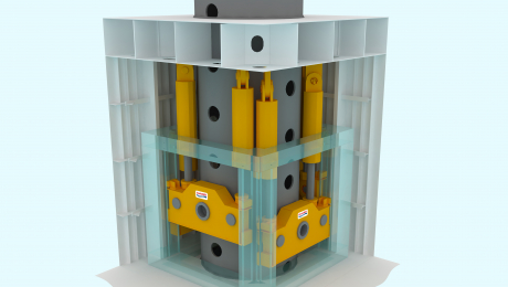

The CJS consists of four robust steel legs, with four movable jacks fitted around each leg, each connected to the piston rod of two hydraulic cylinders. The legs are first to be anchored into the seabed in a controlled manner, after which the vessel is lifted entirely out of the water, providing a kind of stable “construction platform” for erecting the windmill with the onboard cranes. Using hydraulically powered pins that drop into the holes in the legs, three jacks remain connected to the legs at all times during the leg and vessel movements. The “separate” fourth jack is then moved to the starting position, after which it is anchored with the pin, and another jack is sent from the end position to the starting position. This makes it possible to place the leg on/in the seabed in one uniform motion, allowing for three-dimensional stabilization of the vessel and for lifting or lowering it at a constant speed. The movement pattern is extremely complex. It is regulated by the controls, the cylinder displacement sensor systems and other various sensors. This means, for instance, that the cylinder of the jack that returns to the starting position moves much faster than the other cylinders that are lifting the vessel out of the water at that moment. This represents a new way of integrating hydraulics, electronics and software.
A total of 32 hydraulic lifting cylinders are active during the jacking up movement. There are another 16 cylinders for moving the anchoring pins, while the jacking system consists of valve blocks, the control system and specially designed software. Testing and commissioning takes place on site by GustoMSC in collaboration with Bosch Rexroth in Japan.
