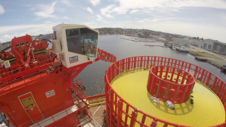

Following the demands of their customers to work with increased cable lengths, Blue Offshore, a rental company for specialized cable laying equipment, decided to upgrade the capacity of its existing equipment. Bosch Rexroth from Boxtel was approached, to increase the pulling force of the hydraulic cable tensioner and to upgrade and modernize the complete hydraulic installation.
"This was a challenging and evenly exciting job," says Remco Buskens, Sales Engineer Specialized Services at Bosch Rexroth. "The complete installation of Blue Offshore is based on hydraulic drive and control technology, and was thoroughly checked, serviced, modernized and upgraded. The subsea cables are stored in huge basket carousels for offshore installation, driven by hydraulic motors. Also the two rubber tensioner tracks that accurately guide the cables, are adjusted relatively to each other by means of hydraulic cylinders. To store an increased amount of cable, the height of the basket carousel had to be increased. The ‘cable guidance device’ in between the basket carousel and the tensioner is tilted by a hydraulic cylinder, as the angle of the cable changes when the amount of cable on the storage wheel in- or decreases. Powered by a dedicated 37kW hydraulic power unit, this complete installation can be defined as a stand-alone unit.”
