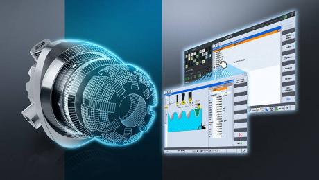

CNC machine tools from DMG MORI have always stood for productive and highly accurate machining. This already begins in NC programming, where the exclusive DMG MORI technology cycles, the digital assistants of shop floor-oriented programming, have enabled more efficient and reliable processes for many years. The range includes a total of 50 technology cycles for handling and machining as well as monitoring and measuring. DMG MORI illustrates the progressive development in this area with the presentation of eight new technology cycles.
“Today, technology cycles are the backbone of workshop-oriented programming because they ensure maximum efficiency and reliable processes,” explains Dr. Ing. Edmond Bassett, Head of Technology Development at GILDEMEISTER Drehmaschinen GmbH. In view of increasingly complex workpieces, it is only possible to significantly optimize manufacturing processes with technology cycles. “These programming assistants, which are fully integrated into the control, enable programming that is up to 60 percent faster, a clear program structure and a minimal error rate.” In addition, DMG MORI places a great deal of focus on the integration of advanced technologies in order to sustainably optimize manufacturing chains through complete machining strategies. This is confirmed by a look at the new DMG MORI technology cycles now presented.
