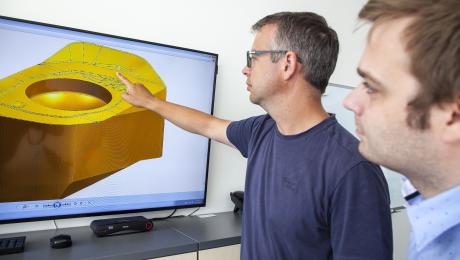

Jan began the process with Jan Vlcek from the company’s product design & information department, responsible for all aspects of tool development. This includes creating high quality data on every tool produced, the design of products and supporting manufacture.
The department’s first task in designing a new high feed milling tool – later known as SBN10 - was to research what products were already available in the market from competitors and how Dormer Pramet could be different, while still meeting the needs of customers.
Jan Bittner said: “We started with a series of preliminary studies and initial prototype designs, putting a number of ideas forward before we could start to produce samples. There are always difficulties and challenges to overcome, but some small changes at this stage can have a big impact.
“For example, with one of the first samples created, we realized there was a conflict with an existing patent from a competitor. With many companies creating new inserts all the time, it is a very crowded market.
“However, we worked with the designer to modify our concept to make it unique, whilst still fulfilling the original brief. This led us to liaise closely with colleagues in Sweden and North America to make sure our designs did not conflict with any patents.
“We discussed with colleagues in Intellectual Property (IP) how we can make our design unique and this was a new experience to me.
“At each stage, we were in discussions with IP over the design and any slight changes being made. We needed to confirm we were within patent pending at every point and not conflicting with others already submitted. Eventually we were given the ok to proceed.
