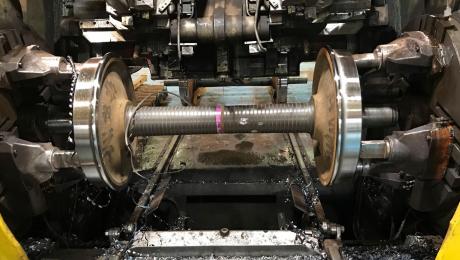

Wheel returning
Another example where Dormer Pramet provides support to the railway segment is in wheel returning. This too can see standard tools being modified to become custom-made specials, unique to the requirement of the application.
A customer in Philadelphia, USA, was having issues with its previous LNMT inserts as they were not able to break chips during a wheel turning operation. The resultant long, continuous swarf congested the area around the workpiece. The process to clear the chips is not only time consuming but can also be hazardous.
Dormer Pramet put forward its standard LNMT inserts, but during tests, found these too did not break the chips as required. Following further feedback and discussions with the customer, the company was able to make two key changes to its insert. First it added a corner radius chip breaker to relieve some of the pressure on the tool. It then tailored the geometry and design of the insert to prevent nesting at high depths of cut.
The end user wanted to make one pass, so the LNMT insert needed to be able to achieve a staggering .700” (18mm) depth of cut at the first attempt. Following the changes, the insert was put in for further testing.
Not only did this new design fix the chip control problem, but it consistently outperformed all other inserts tested. The customer now orders its inserts from Dormer Pramet.
