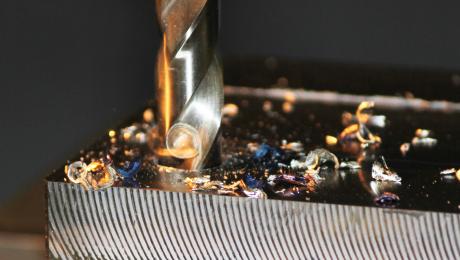

In general CNC machining environments, maximizing drilling speed, while maintaining required hole-quality, is often favored as it can result in greater cost savings. However, for the MRO engineer, safety and reliability is paramount. It is therefore important to understand the connection between the features of the drill-point geometry and the allowable penetration rate.
The rake angle, for example, is measured at the peripheral corner and approximately equal to the lead of helix. However, it changes along the length of the major cutting edge, getting smaller to eventually become negative near the drill axis. This improves the sharpness of the drill, which in turn, reduces the amount of torque required.
Just like the rake angle, the clearance angle also changes in the radial direction. But where the rake angle decreases from the peripheral corner to the drill axis, the clearance angle increases. This helps to create a smooth exit hole during hand-held operations.
Also, the chisel edge is the first point of contact, pushing into the material. However, it doesn’t cut the work-material, but instead displaces it while penetrating. As a result, the chisel edge creates most of the thrust forces exerted. The geometry of the chisel edge, together with the point angle, determines the centring characteristics which control hole positioning, size and straightness.

A cutting tool which features these characteristics is the popular Dormer A100 HSS drill. Suitable for drilling a variety of materials, such as steels, aluminum and stainless steel, the versatile A100 is ideal for hand-held applications. Its strong 118-degree standard point is easy to re-grind and a steam oxide finish prevents the work-piece material from sticking to the cutting edge.
Also, the legendary Dormer A002 general purpose jobber length drill, developed more than 20 years ago, continues to be sold in huge quantities around the world. Providing a smooth cutting action and consistently high quality, in a wide variety of materials, its self-centering split point offers excellent positional accuracy.
Its lesser known cousin, the A108, features a split point and a quick-spiral helix specifically for machining stainless steel. A sharp geometry limits the onset of work-hardening and a steam tempered surface treatment helps retain cutting fluids and prevents material sticking to the cutting edge. Manufactured from M2 grade of HSS, which is one of the toughest available, make it ideal for hand-held operations.
The Dormer A777 and A117 high speed cobalt jobber and stub drills provide another option for hand drilling. Their heavy-duty design makes them suitable for machining high-tensile, tougher materials, such as tool steels.
A 135-degree split point design helps with self-centering when used by hand and reduces the push force required. A bronze oxide finish prevents work-piece material from sticking to the cutting-edge during usage.
