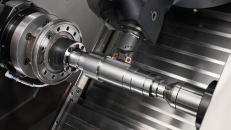

Grinding, turning, milling and measuring processes in one clamping
Innovative answers for reducing this effort are provided by the DVS machine series DVS UGrind, through which the DVS TECHNOLOGY GROUP is utilising its expertise from the field of the hard-fine machining of large series for medium to small batch sizes. Thanks to the multi-functional turret and the intuitive operability using an in-house developed user interface, the overall machining time for manufacturing corresponding components is reduced by up to 50% – at the same time ensuring maximum flexibility. Depending on customer- or component-specific requirements, the machines in the series perform grinding, turning, milling and measuring processes in one clamping and with minimum travel thanks to their extraordinary compactness. The integrated measuring probe controls and monitors machining until the required final dimension has been achieved, which means time-consuming processes such as successive feeding and re-measuring are no longer required. Optimised lever arm ratios and the vibration-damping machine bed made of granite guarantee a high degree of dynamic and thermal machine stability, thus ensuring constant reproducibility of the required manufacturing qualities. These are optimum pre-requisites for the use of the machine series for machining powertrain components for electric vehicles. On account of the comparatively higher rotational speeds and transmission forces in this context, as well as the striving for greater concentricity and NVH-reduction, the requirements related to shape and position tolerances become more demanding. This in turn results in the necessity of even more precise machining of the respective components. With the aid of the DVS UGrind, BUDERUS Schleiftechnik fulfils this premise reliably and economically, as the company demonstrates using the example of hard-fine machining of a complex hollow shaft for electric drives. Figure 1 shows the different machining operations that can be carried out on different surfaces of the hollow shaft using the flexible multi-function turret which can be configured accordingly using appropriate tools.
More stringent shape and position tolerances require maximum manufacturing precision.
First, a level surface is measured using the measuring probe located on the multi-function turret that permits a radius of action of 270°, in order to exactly determine the axial and rotation position of the workpiece and ensure that all the lengths and a complex key surface are complied with precisely. On the basis of this, the control system calculates optimum feeding and forwarding parameters, after which the key surface is manufactured exactly using a CBN hard milling tool. Then a combined turning steel holder with two blades is used for high-precision hard turning of various flat surfaces on the left and right, which is followed by the CBN grinding of several outer diameters down to the last µm. For the precise grinding of the long outer diameter, plunging takes place at several points first, and then peel grinding is carried out from left to right. The CBN grinding disc, which stands out thanks to its extremely fine grit, is then used to finish the seal seat of the hollow shaft, during which a surface roughness of Rz < 1 µm is achieved. A reference outer diameter is machined measurement-controlled with the aid of in-process measuring equipment. The other outer diameters are traced following this reference. Since the execution of all machining operations takes place in one single clamping, set-up times and the number of manual handling steps are reduced and reclamping faults avoided completely. The use of high-quality and high-performance tools and short travel paths permits minimum cycle times.
