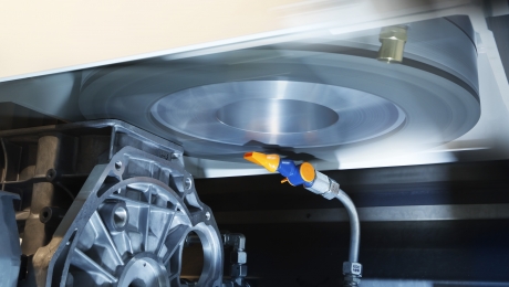

Face grinding rather than milling
The grinding pioneer, DISKUS WERKE Schleiftechnik GmbH, is familiar with these problems. For more than 100 years now, the Dietzenbach-based company has been in the business of face grinding and double face grinding. In this particular case, the technology leaders were extremely inventive. They replaced milling by face grinding technology. With a correctly designed, conventional grinding disc it is now possible to machine approximately 10,000 engine blocks without intermediate dressing. A comparison of the tool costs established that at approx. 0.018 € per workpiece, the grinding tool only makes up around ten percent of the costs incurred during the milling process on account of the long service life. In addition, the workpieces are ground so precisely that their tolerances are only used to one third.
90% lower tool costs
The tolerances required for the combustion chamber sealing surface are kept small, in line with their later function in the interaction with cylinder head and gasket between the two components. The tolerances shown in the table of the gallery are to be assessed critically.
Special attention is paid to waviness and evenness, since these tolerances directly influence the service life of the cylinder head gaskets. The parallelism to the crankshaft axis or sump face guarantees problem-free camshaft drive and combustion chambers of the same size, in interaction with the cylinder head. As far as parallelism to the sump face is concerned tolerances from pre-production– the milling of the sump face – also have to be taken into consideration. These manufacturing deviations minimise the specified tolerance during milling of the combustion chamber face. The crankshaft gap can also be used as the reference plane if necessary.
Conclusion: Compared with competitive milling technology, the given manufacturing tolerances can be achieved reliably at significantly lower tool costs.
