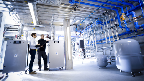

The ETA factory, however, is primarily - as a large-scale research laboratory for industrial energy-efficiency, helping the German government to halve energy consumption by 2050 in comparison to 2008. In this context, the industrial sector plays a crucial role, since according to the German Federal Environmental Agency it consumes nearly a third of the total energy in Germany. Reason enough for the nation’s Federal Ministry of Economic Affairs and Energy (BMWi) to subsidise the ETA factory’s construction, its entire equipment and its long years of research work with 15 million euros.
Improving the interaction of all components
It is tasked with holistically improving the coordinated interaction of all a factory’s components and systems – from the machine tools to the building’s technical equipment and envelope, so as to downsize its overall energy consumption. On the same area as a typical indoor handball court (around 800 square metres), there is not only a learning area for students and employees from the industrial sector, but also a machinery zone with machine tools and cleaning machines plus a hardening furnace – an environment in which components for pumps (to be precise: control disks for hydraulic axial piston pumps) are produced: the ETA factory covers all stages of industrial manufacture, from the blank to the finished part.
The production of pump components, however, is only a means to an end, since it’s here that new concepts for energy savings are being developed under real-life conditions. The former state of the art has been that individual components are scrutinised separately,” says Institute Director Professor Abele. “In conjunction with machinery manufacturers, construction engineers and architects, we are aiming to analyse and optimise on a cross-disciplinary basis machine components, production machines, the process chain, a building’s technical equipment and its envelope from the viewpoint of energy-efficiency.”
Besides design-enhancing production processes, other focuses include the coordinated interaction between the technical equipment and the machinery. The technical leitmotif here is multiple networking of the factory’s individual modules: a heat network links the machines together and to the building’s envelope using heat pipes. The façade incorporates an integrated array of very small tubes, enabling it to react to the temperatures outside, and respond accordingly, either by cooling or heating the water in the pipes. It is supported in heating the factory hall through the heat networks by the waste heat from the machines, though this is also utilised by other systems, like the hardening furnace. “Customarily, the water used for cooling the machine’s drive elements is continuously cooled down again,” says Prof. Abele. “This is simply a total waste of energy. We now no longer cool down the entire water supply, we even heat it up a bit to 80 degrees Celsius – for the downstream system that cleans the metal parts, to cite one example.” For cooling the drive elements, the machines instead use cold water from the mains.
The ETA factory also possesses a data network that links together all the areas involved, “We combine the control of energy consumption with Industry 4.0,” emphasises Professor Abele. “In this way, the acquired and edited data, meaning “big data”, can be used for optimising the energy consumption.”
