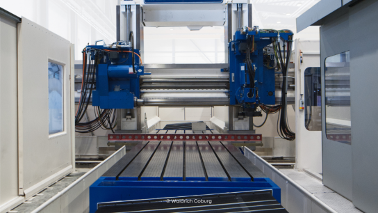

The general overhauling of machines represents an important branch of business for machine tool manufacturers. What can be achieved here is demonstrated by Waldrich Coburg which manufactures not only very large horizontal and vertical milling machines but also vertical lathes and grinding machines. Three machines are given a complete retrofit every year or so. As Retrofit Project Manager Steffen Nitzsche explains, the company already uses highly recyclable materials such as cast iron and steel for its products, thus reducing the consumption of natural resources. Very little plastic is used. The machines have hydrostatic guides that exhibit virtually no wear and are merely regarded as "well run in" after 30 or 40 years, the expert notes. For example, he describes a gantry milling machine which was built in 1981. The machine – with imposing floor plate dimensions of 3,600 mm x 13,500 mm, a passage width of 4,600 mm and a passage height of 3,500 mm – received a milling support system that was mechanically and electrically completely overhauled and modernized, and a modern gantry drive. All feed gears were also overhauled in the process. The machine was given a completely new electrical system as well as a modern Siemens 840D control unit, new axle drives, and hydrostatic and hydraulic components.
Overall, around 90 to 95 percent of a machine’s weight is retained during such retrofitting. The remaining 5 percent usually consists of control cabinet and cable materials. These are not disposed of either, but are handed over to an external service provider, and 30 to 40 percent of them reused.
"New from old" as an alternative to investing in new equipment
Matthias Helmprobst, Head of Control Technology at Waldrich Coburg, is keen to point out that it is not only possible to completely overhaul a machine that is 40 years or older, but also to upgrade it to the current state of the art. After the overhaul, the fact that the machine uses the latest control and computer technology in conjunction with the latest operating systems and safety architectures means that it also meets the current IT standards and can thus be integrated into the company network, for example. Depending on the scope of the work involved, the financial outlay for modernization ranges between 30 and 60 percent of the cost of a comparable new machine and is therefore often the more economical alternative.
At Waldrich Coburg, the topic of the circular economy is accorded a very high priority, emphasizes Matthias Helmprobst. In his view, whether or not it is implemented is based less on technical possibilities, but is rather a question of mentality. "A lot of people feel that a 40-year-old machine must be antiquated," he says, adding: "We need to change such thinking if we want to move production forward in terms of the circular economy."
