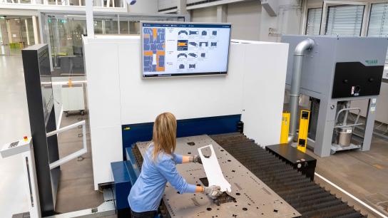

Smart sorting assistant from Trumpf
Artificial intelligence is also used to operate the Sorting Guide, a system created by laser specialist Trumpf in Ditzingen, Baden-Württemberg, Germany, that helps sort produced parts and thus increase machine utilization levels. The Sorting Guide is a camera-based assist system that relies on decentralized machine learning. The main components of the AI system are a high-resolution camera, a large screen, an industrial PC and intelligent software for image processing.
"Decentralized machine learning involves linking together several machines to form an AI system," says Prenode CEO Hirt, explaining the principle. These machines continuously collect local data about their work processes. An AI model is developed for each machine, which is then centralized. “These models are then merged in a central cloud and transferred back to the individual systems," Hirt continues. The AI system can then draw locally on the experience of all the other machines without ever having to share sensitive raw data. "This allows the machines to run their processes more efficiently and achieve greater productivity," Hirt promises.
Trumpf’s Sorting Guide works as follows: The Sorting Guide uses existing master data and self-learning image processing to recognize the individual parts. It then issues a sorting recommendation on the screen. The manufactured parts are shown in different colors on the screen – coded by customer order or subsequent work steps such as bending, deburring, lacquering or shipping, for example. This makes aspects such as the time-consuming recounting of parts, manual confirmations and accompanying documents things of the past. Machine operators can see at a glance which parts are ready for further processing and whether post-production is necessary or not. This speeds up the sorting process and helps avoid errors – allowing the machine to return to production more quickly. AI and manufacturing go hand in hand, as humans and machines need to work together closely in the industrial production environment.
