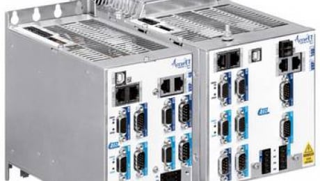

ETEL designed the AccurET VHP to reach sub-nanometer position stability combined with extremely low tracking errors during dynamic motions and to control the most demanding axes in terms of speed accuracy. AccurET VHP range was shown, for the first time, at SPS/IPC Drives in Nuremberg (Germany) in November 2016.
For the most demanding applications, ETEL developed a unique Very High Performance position controller range called AccurET VHP. This range of product is equipped with both specific hardware and software that maximizes the performance. AccurET VHP position controllers are compatible with all the other AccurET controllers and can be dedicated to the most demanding axes of a multi-axis motion system. In fact, it is the same decentralized architecture as used in the AccurET modular. This allows an important part of the machine control software to be located at the axis level. In addition to the benefits of ETEL controllers such as high computation power, fast and real-time communication bus and state of the art control algorithms, ETEL’s VHP range is providing outstanding signal to noise ratio.
AccurET VHPs are successfully used in areas such as:
  • Process control
  • Wafer inspection
  • Lithography
  • Wafer and die level packaging
  • Test and control equipment
Advanced Features
ETEL has always focused on developing advanced motion control features to make its position controllers unique in the market. In addition to the standard range of products, ETEL offers unique hardware that enables performance otherwise unachievable with conventional technologies.
AccurET VHP (Very High Performance) range includes all software features and advanced algorithms of the standard AccurET range and combines these with a unique hardware design. VHP products are designed specifically to control the most demanding axes in terms of position stability and speed accuracy. To reach sub-nanometer position stability and extremely low tracking errors during dynamic motions ETEL has designed specific hardware.
ETEL's AccurET VHP specific power output stage achieves outstanding signal to noise ratio of 100dB. This unique signal quality provides superior levels of performance both in position and speed stability. In addition ETEL's expertise delivers high levels of current that would be limited in traditional linear amplifier architectures. The unique VHP hardware is the key to combining outstanding positioning performance and high dynamics.
AccurET VHP also provides advanced control features enabling more options and unique algorithms for complex motion systems. For instance, AccurET VHP provides High Speed Encoder Interfaces (HSEI) to enable extremely high resolution position feedback in combination with high speed motion.
