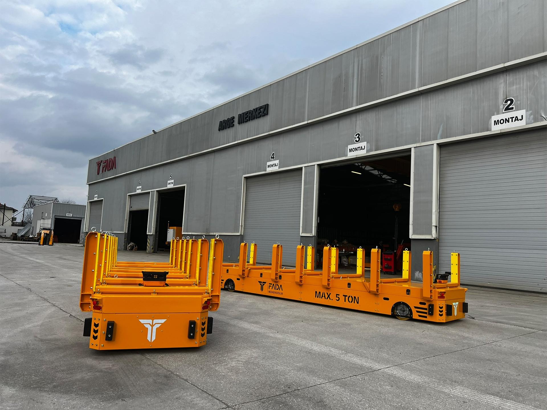

Safe and Ergonomic Transport Solution for Hot Profile Products
Customer Need:
In the metal manufacturing industry, the client required a reliable and efficient solution for transporting hot profile products between production lines within the factory. These products, due to their high temperature and delicate structure, demanded a transport system that could ensure safety, prevent damage, and maintain ergonomic handling for operators. The goal was to enhance productivity while minimizing the risk of injury and product deformation during the transfer process.
Project Challenges:
The project posed several critical challenges:
  • Extreme Heat Resistance: The transfer vehicle had to operate in a high-temperature environment without compromising performance or safety. This required advanced thermal insulation to protect both the vehicle’s components and the operators.
  • Product-Specific Design: The thin and elongated structure of the hot profile products required a customized design to securely hold and transport the items without bending or causing structural damage.
  • Operational Safety and Control: Ensuring the safety of operators and factory staff was paramount. A system that allowed precise and remote control was essential to avoid direct exposure to heat and potential accidents.
  • Durability and Efficiency: The vehicle needed to withstand continuous operation in a harsh industrial setting while maintaining efficiency and reliability.
Our Solution:
To meet these complex requirements, we developed a state-of-the-art, remote-controlled transfer vehicle with a focus on safety and ergonomics:
  • Advanced Thermal Insulation: The vehicle was equipped with high-quality heat-resistant materials and insulation layers to protect its internal components and maintain performance under extreme temperatures.
  • Custom Geometry Design: The structure was tailored to securely cradle thin and long profile products, preventing deformation or damage during transport. Adjustable holding mechanisms were incorporated to accommodate different product sizes.
  • Remote-Controlled Operation: By integrating a wireless control system, operators could manage the vehicle from a safe distance, minimizing exposure to heat and ensuring precise handling.
  • Enhanced Safety Features: The vehicle was designed with an emergency stop system, anti-slip surfaces, and ergonomic controls to improve operator safety and comfort.
This innovative solution not only optimized the transportation process but also significantly improved workplace safety and operational efficiency.
