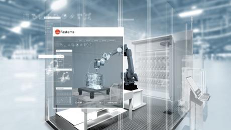

The intuitive software uses the advantages of CAD-generated paths and thus offers robot programming similar to that of any multi-axis machine tool. Powerful virtual tools enable the user to ensure the reach of the robot and thus collision-free movements during machining.
In this context, Fastsimu checks the cycle times, simulates the tool change, monitors the robot joint limits as well as speeds and accelerations.
By simulating different tools for specific finishing tasks, the user can virtually test the suitable tools prior to finishing and, if necessary, order new tools in good time before production. Fastsimu also accelerates the product development cycle by simulating deburring and finishing tasks without the need to create a physical part.
The new version of Fastsimu includes several enhancements, including a user-friendly interface, optimized performance for simulating and importing CAD models, and advanced robot path control. With Fastsimu, the workpiece can be programmed before it even exists, resulting in significant savings regardless of the workpiece and lot size.
