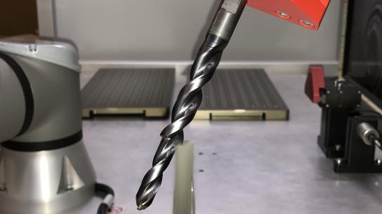

Only very few processes can influence this with high precision. The options are more than limited, especially for some processes such as microblasting, vibratory finishing, wet blasting or magnetic finishing. AT-Robotics from Stuttgart, on the other hand, which will also be represented at the Startup Hub, has developed a hitherto unique automated process that can clearly determine the K-value of a cutting edge and influence it precisely. With a total of six different robot axes, the tool can be moved through a rotating diamond brush at different inclinations. Rounding is carried out with a precision of a few thousandths of a millimeter, i.e. in dimensions that are far smaller than the diameter of a human hair.
The result of this high-precision cutting edge preparation is a significant extension of the life cycle of the cutting edge. "Thanks to the longer service life and the associated cost-effectiveness, the use of our system pays for itself within six to nine months," said Tomislav Anic, founder and Managing Director of AT-Robotics. Other advantages of the automated process include greater process reliability and higher precision. Since the system also has program templates for various milling, drilling and reaming tools, it enables correspondingly short set-up times. "Another key strength of our system is the machining of step drills. That's because the robot technology enables different cutting edge radii to be applied to different steps," added Anic, who is already looking forward to convincing interested parties of the benefits at GrindingHub.
