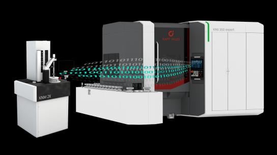

The umati partners and exhibitors at GrindingHub also include the Coburg-based company Kapp Niles, a specialist in machines for the fine machining of gears and profiles. André Wetz, Digital Transformation Project Leader, explains how a modular digital system can be structured. A standardized hardware package (consisting of sensors and an industrial PC with firewall and OPC UA server) provides the basis of the system. Customers can select the software solutions they require, such as condition monitoring of the linear and rotary axes to determine their wear, or component-specific monitoring and evaluation of the grinding and dressing processes in real time to reduce reject rates.
Another digital solution is a closed-loop system that enables the seamless integration of processing and measuring machines.
"Employees no longer need to intervene to measure the workpieces once they’ve been ground," explains André Wetz. The system ensures that data from the processing machine is transmitted directly to the measuring machine. The measurement report is returned to the machine in GDE (gear data exchange) format, which can then make any necessary corrections independently.
André Wetz emphasizes that all the solutions run on the customer’s own machines and in their own network. "This should allay any concerns about any possible loss of data sovereignty or the threat of cyberattacks from the outset," he points out. This allows customers to decide for themselves if and how they want to optimize their performance, and what benefits they want to derive from exchanging data with external parties, such as machine manufacturers or partners in the value chain. According to Wetz, it is above all Kapp Niles customers from the automotive and supplier industry that are currently benefitting from efficiency gains through digital networking. As an example of a particular application, he cites intelligent process monitoring for low-noise gearing. This can be used to identify noisy components during machining and reduce the reject rate. "This provides an effective means of meeting the quality requirements for electric vehicles," says Wetz. At the same time, however, the examples made it clear that networking across company boundaries also yields the greatest added value.
