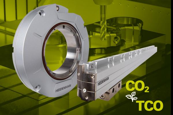

LC and RCN encoders from HEIDENHAIN: 99% less CO2
In the area of machine components, HEIDENHAIN is presenting at AMB the LC linear encoders and RCN angle encoders with optimized optics for crystal-clear sensing, even in the presence of liquid contamination and condensation. In many cases the encoders work just fine without any compressed air. This simplifies sealing-air needs, letting you enjoy the benefits of Closed Loop position measurement at significantly lower system costs. Also, omitting the sealing air reduces the machine's CO2 footprint by up to 99%.
The LB 383 C from HEIDENHAIN: the new scale for long axes
The LB 383 C sealed linear encoder from HEIDENHAIN is the new specialist for position measurement on machines with long axes. It is available in measuring lengths of up to 72 m. Thanks to its sturdy scanning unit, the new LB 383 C is particularly tolerant to contamination and at the same time very rigid in the measuring direction. This increases process reliability and permits significantly more powerful controller parameters, resulting in better machine performance. The LB 383 C also saves money, since its profiles are adapted to those of the LC 200 linear encoders. This not only reduces the amount of stock you need, but also obviates the need for special connecting pieces for compressed air.
