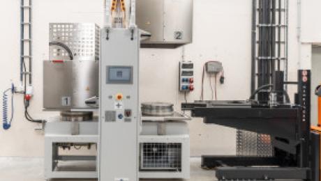

What happens in the new Hermle MPA 42 seems to be paradox at first: The blanks leave the working area of the cutting machine with a mass volume that has not become smaller but significantly larger. The name "MPA" indicates how this feat is achieved: It stands for Metal-Powder-Application, a process developed and launched on the market by Hermle about seven years ago. The new generation of machines significantly increases the precision and speed of the generative manufacturing process.
The new MPA 42 runs in the Ottobrunn premises of Hermle Maschinenbau GmbH (HMG). Since 2009, the wholly owned subsidiary of Maschinenfabrik Berthold Hermle AG has been operating from its Bavarian outpost, developing over the years into a service provider for additive manufacturing. Managing Director Rudolf Derntl opens the doors of the soundproofing enclosure of the MPA 42 which houses a heavily modified 5-axis machining centre of type C 42 U. Next to the spindle, a nozzle projects into the working area but no cooling lubricant spraying device is to be seen. "The de Laval nozzle accelerates the powder and deposits it directly on the clamped metal blank," Derntl explains.
Super-heated steam and nitrogen combined with the geometry of the nozzle accelerate the powder to supersonic speed, deforming the metal particles and allowing them to bond on impacting the substrate. In the rear section of the unit, a steam generator and five powder conveyors are mounted. All application materials and blanks must have the same tensile properties: "Since the application principle is plastic deformation, it works with a large variety of metals. It follows that the surface of the semifinished products must be ductile as well," the Managing Director points out. In addition to the hot and cold forming steels with high carbon content, copper and Ampcoloy are used.

The application engineers generate the code for the control using their own CAM software. It defines not only the movements but also the powder quantities, temperatures, and the alternating between material build-up and milling. "Since no CAD/CAM manufacturer was able to map the particular alternating process – milling, building up, milling –, we wrote our own software. As an extra benefit, we can now promptly accommodate special requests by customers," the Managing Director says. The experts sit right next door.
Once the preparations are completed, the customer sends their blank to HMG. "In 95% of cases, we use a semifinished part prepared by the customer on their own milling machine," customer consultant Oliver Müller explains. The part arrives in Ottobrunn already with pre-milled cooling ducts or pockets. The HMG team checks the blank for dimensional accuracy and compliance with the design specifications. "The pockets must be free of bevels, for example. For powder application, we need sharp edges," Müller says.
Now the heat comes on
Before starting the process, the part is heated up to approximately 300 degrees Celsius in the heating station. Even though the process involves no welding, it requires high temperatures: Substrate and metal powder must be heated for better tensile properties. Steam provides the energy to accelerate the powder. As both components pass the nozzle, the powder reaches the supersonic speed the process needs. To keep the temperature constant during machining, the MPA 42 continues heating the part until the last chip is removed. "In this way, we prevent temperature gradients causing tension, tearing or distortion," Rudolf Derntl clarifies.
Material application and removal alternate during the manufacturing process. After application of the powder, details such as fine fins are milled into the new material, cooling ducts are filled with a water-soluble metal material and closed with a layer of steel by means of a MPA process. "Later on, we flush the filling material out in a water bath to get the desired cavities," Müller explains. The powder jets can implement build-up rates of 200 to 400 cubic centimetres per hour, and with copper even close to 1,000 cubic centimetres.
