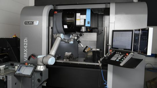

Automation with ProCobots
At the Hanover trade fair, HURCO will present ProFeeder, a solution that’s part of the company’s own ProCobots brand. ProFeeder can be used with different HURCO machines, based on operational needs. At EMO, the parts-handling system will be shown working with the TM 8 Mi lathe. The cobot is mounted on a chassis with wheels for this demonstration. It requires just one automatic door, which can be ordered as part of a new project. The doors can be retrofitted on all the machines ordered.
The ProFeeder is easy to integrate into your processes. Just set it up via the user-friendly WinMax software from HURCO and the Automation Job Manager solution developed specifically for ProCobots. “The flexible performance of our control system is plain to see here. With the automation solution, its job manager loads the parts without problems,” said Sebastian Herr. “The cobot’s software is not required. This eliminates problems with data transmission and accelerates your processes. With the two screens, the operator also gets to work in a familiar environment the whole time. Plus, the interfaces haven't changed. There are lots of images, not much text – and all the other features of the WinMax control system. The system is fast. It is also dialog-oriented and includes every step that needs to be initiated in automated parts handling.”
