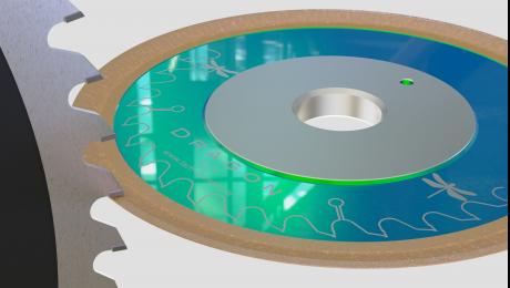

DragonFly sets new standards for tool grinding shops. This innovative grinding wheel provides highe
lach-diamant news Image
This innovative grinding wheel provides highest precision and efficiency for machining carbide-tipped saws.
Hanau:LACH DIAMANT succeeded in developing a highly innovative grinding wheel for the tooth-face grinding of circular saw blades. This makes machining more cost-efficient – while maintaining highest precision.
The unique carrier system with 3-dimensional geometry and extended grinding layer-surface allows for effortless grinding of even the smallest tooth gaps.
To date, the grinding of rakesurfaces on carbide-tipped saws frequently reached its limits – especially regarding stability and efficiency. The new DragonFly grinding wheel sets new standards with its unique carrier system: Higher infeeds and feed rates reduce grinding times drastically, the removal volume is increased, while producing exemplary, and even rake surfaces – without any “buckling”.
The DragonFly grinding wheel provides steady and secure grinding of carbide-tipped saws: “The DragonFly wheel grinds without any problems, is very precise and has a significantly higher lifetime than all previous wheels”, states one of our satisfied DragonFly customers.
The DragonFly wheel (tooth-face grinding) is accompanied by the DragonFly Back Cruiser for back grinding as well as the DragonFly Flank Cruiser for side grinding (from left to right).
