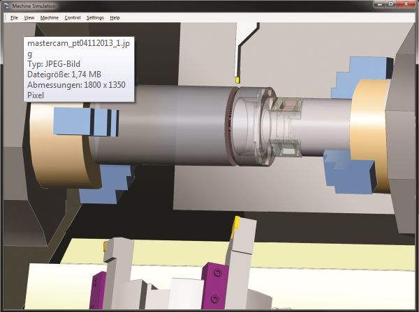

New Mastercam Mill-Turn
Mastercam’s Mill-Turn product makes machining on today’s high-powered turning centers and full-function machining centers simpler and easier than ever before. Mastercam Mill-Turn streamlines the programming process with intelligent job setups that are keyed to the exact machine in your shop. Intelligent work plane selection makes it easy to select the proper spindle and turret, and program your part with Mastercam’s proven milling and lathe toolpaths.
