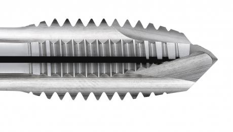

During the manufacture of taps, the grinding process creates burrs between the thread profile and the chip flute. Bur-free grinding is simply not possible, so extensive finishing is absolutely essential. If the taps are not deburred, then adverse effects on the geometry of the cutting edge cannot be excluded. What is more, burs on uncoated tools can interfere with the cutting edge during chip removal or break off and damage the cutting edge and thereby considerably reduce tool life, impair the quality of the surface and degrade dimensional stability.

OTEC has developed several surface finishing processes of threading tools. In stream finishing machines with pulse drive (Pulsfinish) the tools can be processed reliably, quickly and economically according to the requirements. The principle of pulse finishing system is based on the precisely defined and rapidly repeating relative movement between media and workpiece. Here the clamped workpiece is immersed in the media stream of the rotating drum where it is quickly accelerated to a speed of over 2,000 rpm. Then it is decelerated again and accelerated once more. The differing speeds resulting from the inertia of the media in the drum and the rapid change of workpiece speed give rise to an extremely intense and precisely controllable abrasive effect.
Compared to conventional processing methods, several production steps can be saved using the pulse finishing process. Deburring, smoothing and rounding of the edges in one operation enable time and cost savings. A surface which has been treated with the OTEC process also improves the adhesion of the subsequent coatings and extends the tool life.

Taps in general need a deburring process after the tool grinding. With the conventional brushing method, never all burrs can be removed, which affects the later coating negatively. Non-removed burrs break off and create uncoated areas that wear more quickly. In OTEC’s stream finishing machines with pulse drive (Pulsfinish) workpieces can be deburred within several seconds up to some minutes.

Cutting edges can be rounded to a defined measurement. By setting the parameters container and workpiece rotation speed as well as the immersion angles the geometry of the taps can be modified in order to match the requested and optimal shape
