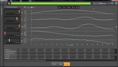

The new ‘free-run mode' in CARTO 2.1 software allows users of the XM-60 calibration system to capture data immediately, without having to define the positions, or even the number of targets. The software displays straightness (horizontal and vertical), pitch, yaw and roll errors against linear position. Triggering can be manual (with a keypress), automatic (based on stability of position) or continuous (captured during motion at a user-defined interval).
An example of one of many applications that would significantly benefit from ‘free-run mode' is during machine tool assembly. The mode can be used to check the straightness and roll of an axis before moving to the next stage of assembly, and all before the control system is complete. Stage manufacturers will also see a benefit in what is the fastest method of multi-axis measurement.
