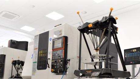

Equator gauging systems have helped to improve yield and increase process capabilities of production lines around the world, by providing high accuracy dimensional inspection data next to turning and machining centres, at the point of manufacture. The new larger Equator 500 system now enables the gauging of larger parts, with a working volume of 500 mm in diameter and up to 400 mm in height.
Both Equator 300 and 500 systems are accurate between 5 ºC and 50 ºC at any rate of temperature change, and are capable of scanning speeds in excess of 200 mm/s. Every system is compatible with simple-to-use Organiser operator software, EZ-IO software for automation, and IPC (intelligent process control) software for updating tool offsets on CNC machine tools.

The Equator 500 has a gauging volume of 500 mm diameter in the X/Y plane and 250 mm in Z when used with the SM25-2 scanning module. This can be expanded to 400 mm in Z with the SM25-3 scanning module, which allows styli up to 200 mm in length to reach many more features. The base of Equator 500 supports workpiece and fixturing with a total weight limit of 100 kg. The ratio of gauging volume to footprint means that the machine is extremely space efficient, with a footprint of just 920 mm by 924 mm. This allows manufacturers of larger parts to easily fit Equator 500 onto the shop floor alongside their production machines. Typical applications include the manufacture of car and truck transmission and engine casings, drive-train parts like conrods and differential housings, suspension castings, pressed parts, valves and pumps.

The Equator range is compatible with new IPC software which allows constant monitoring and automatic adjustment of a machining operation, keeping part dimensions close to nominal and well within process control limits. This correction of process drift improves part quality and manufacturing capability, and reduces scrap. The proximity of the Equator gauge to the CNC process allows adjustment at the point of manufacture, avoiding time delays or reliance on finished part (tailgate) inspection. An Equator gauging system can be connected to one or multiple CNC machine tool controllers.
