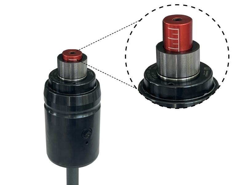

Innovative hollow piston cylinder for dies with clamping edges of different heights
The new hollow piston cylinder clamps dies with clamping edges of different heights. This makes forming work easier, especially for contract manufacturers who use different, non-standardized die clamping edges.
According to the manufacturer, the unrivalled element can be used for clamping edges with a difference in level of up to 30 mm. The desired height can be set in increments of 1 mm. The new hollow piston cylinder offers clamping forces of 60 or 100 kN and can be used with an operating pressure of up to 400 bar.
