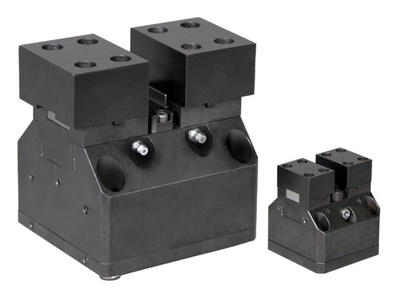

A new double-acting centric clamp in a particularly compact design for small workspaces is also celebrating its premiere at the trade fair. In its pneumatic version, it clamps with up to 14 kN, hydraulically driven even 20 kN, which is why it bears the nickname "Power Clamp". It is suitable for both internal and external clamping and has a centring accuracy of ±0.01 mm.
Available equipment options include clamping stroke monitoring, sealing air, quick-change jaws and RFID chip recognition.
