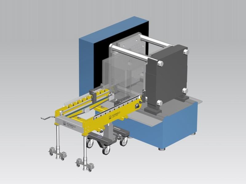

Laubach, September 18, 2024. ROEMHELD will premier at the Fakuma trade fair a flexible die changing console that can be used to load different injection moulding machines without a crane.
The set-up time optimizer will also present a wide range of components for complete solutions designed to handle moulds and dies along the entire process chain — from the rack to the machine.
ROEMHELD will be showcasing their new die changing console and product range for storing, transporting, changing and clamping at Fakuma from October 15 to 19, 2024, in Friedrichshafen, Germany, in Hall 1, Booth 1223.
New, flexible console for die and mould changing
ROEMHELD’s new console simplifies die and mould changes on injection moulding machines. It is mechanically driven, movable and height-adjustable so that it can be used flexibly on different machines.
Roller feet help move the console to the desired machine and a lifting column raises the work surface to the correct height. There it is attached in place via a docking system and secured to prevent unwanted movement.
The mould can then be moved laterally from a transport cart onto the carrying console. To facilitate this, a circulating chain is attached and a crank handle permanently fixed to the console helps move the mould, first onto the work surface and from there, further into the system.
The new die changing console makes it easier to transport and change heavy loads between different storage and production sites. It is available in numerous variants and for all die dimensions and weights. In addition to standardized consoles, ROEMHELD designs customized special versions for almost all requirements on request.
