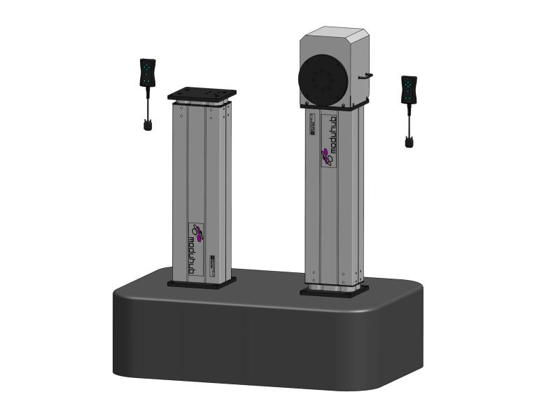

Pioneers: new lifting column for New Generation series
“moduhub New Generation” is the name of the new modular system that will premier its first modules at Motek. This new series consists of components that are more powerful, more versatile and to some extent network-compatible. ROEMHELD has also modernized the design and simplified production so that customers benefit from lower prices. In the near future, the new modular system will be expanded incrementally.
The new product range is starting with electric lifting columns. These lifting columns have four force levels for workpiece weights of up to 500 kg, offer strokes of up to 600 mm and speeds of up to 50 mm/second to enable short cycle times. Optionally, rotating modules with continuous rotation can be added to the lifting columns.
The slots integrated in the outer profile make it possible to attach bulkhead brackets, shelves and holders. These move with the lifting axis or maintain position relative to the operator if the lifting axis is aligned accordingly. Installation with the outer profile with the grooves at the top offers improved resistance to dust and dirt. Alternatively, the columns can be operated by hand panel or foot switch. Batteries for an independent power supply are included in the extensive moduhub modular system, as are rotating and cart modules.
In addition to the electrically operated models, there will be a new manual version with a hydraulic lift drive with foot pedal. It can move workpiece weights of up to 600 kg over a stroke of up to 600 mm.
New moduLift with large stroke (with rotary axis as an option) and new rotating module
ROEMHELD is expanding its existing moduhub modular system with the stationary, electrically operated moduLift with rotation axis for workpiece weights of up to 40 kg. In the version without rotation axis, workpiece weights of up to 80 kg can even be lifted to the optimum assembly height where they can be machined ergonomically and safely.
This innovation is characterized by a large stroke of over 1200 mm, which is achieved at a speed of up to 60 mm/second. Both axes are operated via a hand panel or foot switch and are self-locking in any position. A shutdown function prevents collisions when the component is lowered. The optional rotation axis can rotate workpieces continuously.
The new rotating module with electric drive also enables continuous rotation for workpiece weights of up to 150 kg. It can be easily combined with all lifting modules of the moduhub modular system and is offered at an attractive price thanks to its robust and simple design.
