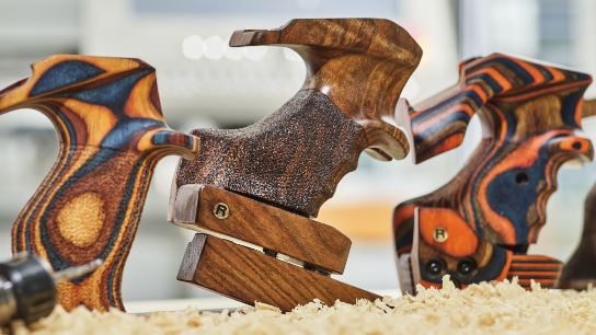

Much of the company’s success is built on providing one-off tailor-made pistol grips and stocks for professional marksmen (in addition to a range of standard grips and stocks). Such is the demand that Mr. Rink comments “We are particularly proud of the individually tailored grips for which our customers come to us from all over the world and accept waiting times of 6 months”.
An extensive selection of pistol types from well-known manufacturers such as Feinwerkbau, Pardini, Steyr and Walther have all been modelled using their Pictures by PC CAD/CAM software from SCHOTT SYSTEME. These CAD models provide the pistols mounting areas that need to be milled from inside the grip so that it perfectly marries to the customer’s pistol, with Rink commenting “So far, we have used the CAD functions to design the various gun models and we have around 100 in our program”.

In a world where 3D printing is for many increasingly in focus, Rink remains with more traditional manufacturing methods, explaining “Various manufacturers have already tried 3D printing, but the feel of a real wooden handle cannot be achieved.”. Even with the development of 3D printing materials, he elaborates “Even so-called wood filament does not offer the sweat absorption capacity of solid wood.” – a factor which is a vital requirement of the grip as any slippage while holding the pistol ultimately effects shooting accuracy.
The company therefore continues to rely on their three ISEL 3 axis CNC machines coupled with their Pictures by PC CAD/CAM software, both purchased back in 1995. The complete process from digitisation to milling data takes approximately 30 minutes, with the creation of the actual CAM toolpaths only taking 5 minutes. Herr Rink comments “With the many different milling technologies offered by the CAM module, we can perfectly program both the very complex 2.5D internal features and 3D external milling operations.” The machining of the left, right and internal components that make up a completed grip requires approximately 1 hour in total, with the customer choosing from either Walnut or coloured plywood made from Finnish birch.
With the aforementioned dispersal of hand sweat still in focus, the last manufacturing process is the stippling (mechanical roughing) of the skin contact surfaces on the grip. This results in a larger surface so that the sweat can be absorbed and released again more quickly. Additional fine handwork of grinding and polishing is also required to produce the championship winning grips and stocks (Figure 4).
