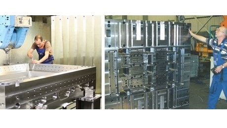

RSB Rationelle Stahlbearbeitung, a medium-sized company in Merkers, Thuringia, relies completely on Tebis software solutions for its NC programming. We took a closer look at Tebis's automated 2.5D process during a discussion with sales manager Arno Volkmar and NC programmer Ralf Wünsch.

Sales manager Arno Volkmar (left) and
NC programmer Ralf Wünsch (right).
