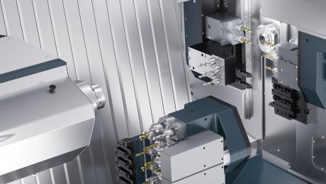

SwissDECO G
The SwissDECO G, with its two plattens, is equipped with nine linear axes. The second platten is equipped with a Z axis used for roughing and finishing operations, frontal operations and deep drilling, for example, and enables operations in differential mode. The SwissDECO G features three independent tool systems and is equipped with two plattens; these machines can also be fitted with modular, pre-adjustable tool systems and devices. Thanks to its configuration, and the ability to use plattens, this solution allows extremely fast chip-to-chip times. Available in 25.4 mm or 36 mm, the SwissDECO G has up to 34 tool positions, 20 of which can be rotating tools.
SwissDECO GA
Based on the SwissDECO G’s kinematics, the SwissDECO GA version has an A axis and three independent tool systems, and accommodates dual platten tools. The second platten is equipped with a Z axis and a device with an A axis that can be rotated 360 degrees. This device can be equipped with 2x3 tools, allowing work in both main and counter operations. Available in 25.4 or 36 mm diameters, the SwissDECO GA, whose A axis can be fitted with up to six live tools can work in both main and counter operation simultaneously and has 36 tool positions, 22 of which can be rotating tools.
SwissDECO T
The SwissDECO T is equipped with a 12-position turret, further enhancing the vast flexibility of the machine. Aimed at the most demanding machining operations and users, this solution’s 12 turrets positions control the live tools and each position can be fitted with up to three tools. Also available in two diameters (25.4 or 36 mm), the SwissDECO T has three independent tool systems i.e. 49 tool positions, 28 of which can be rotating tools. With its internal HP circuit for HP coolant and 36 mm spindle which can be equipped with a high-precision hydraulic brake, the SwissDECO T is conceived to deliver outstanding results on even complex parts. The machine is optionally available with a quick tool-change system to further ramp up its flexibility.
SwissDECO TB
Based on the SwissDECO T’s kinematics, the SwissDECO TB is equipped with a B axis to transform the machine into a turn/mill machining solution to give users the flexibility to perform complex milling operations with one single machine. The solution features a 12-position turret accommodating live tools in all positions and up to three tools per position. Optionally, the machine can work and perform machining operations on five simultaneous axes. As on the T version, it is also possible to fit the quick tool-change system. Available in 25.4 or 36 mm diameters, the SwissDECO TB has up to 49 tool positions, 28 of which can be rotating.
Spindles – the heart of our expertise
SwissDECO 26 machines accommodating 25.4 diameter bar stock feature 10,000 rpm liquid-cooled spindles with 27 Nm of torque and 14,000 N clamping force, and ceramic roller bearings guaranteeing thermostability, precision and durability, even at high loads.
Spindles for the SwissDECO 36 solutions accommodating 36 mm bar stock feature the most powerful spindle ever installed on a Swiss-type lathe: 8,000 rpm liquid-cooled spindles with 53 Nm of torque and 25,000 N clamping force. Thermostability, precision and durability even at high loads are a given, thanks to ceramic roller bearings. To further enhance machining precision, this spindle can be equipped with a high-precision hydraulic brake system; this is particularly useful on machines equipped with a B or A axis.
Flexibility guide bush system
The SwissDECO’s direct-drive guide bush system features a liquid-cooled, direct-drive guide bush for high speed and accurate machining to reduce cycle times and improve surface finish. The machines can be converted to run without a guide bush in less than 15 minutes, and a handy support for the guide bush is located just above the spindle – no disconnection required. An optional three-position guide bush allowing the use of ISO h9 to h11 bars is available.
SwissDECO tooling
Achieving complete versatility is easy with the SwissDECO’s tool holding system which is adapted for use with a presetter. Tooling on the turret can be equipped with an innovative one-screw locking quick-change system, providing excellent repeatability. With Tornos’ SwissDECO tooling solutions, users are on the fast track to a wide range of applications including thread whirling, angular milling, polygon milling, gear hobbing and deep drilling.
